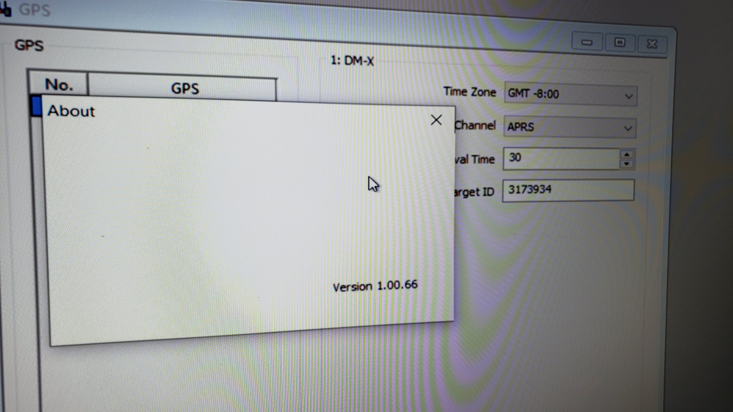

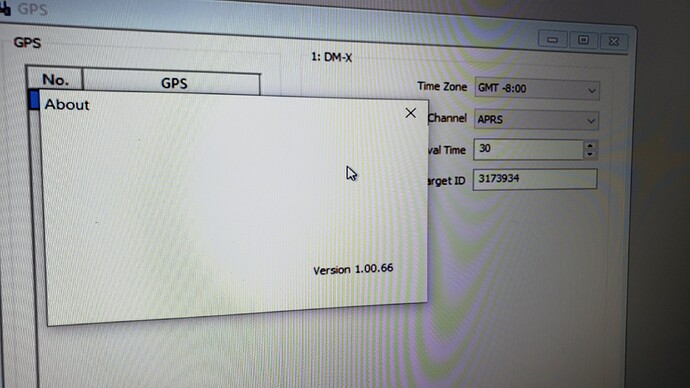

I bought a DM-X about a month ago. It looks like I have latest firmware version v02.02.023. So it has GPS that works and it has a APRS menu. But the MD software really has no options to program APRS. So why does this radio have GPS when you can’t do anything with it? I am hoping that they come out with new firmware and support it. Anybody know anything?

Would you share a picture on the APRS software menu. Maybe it differs in the new version.

what cps version are you using?
you should be using 79
At present, the version of CPS program in China is 79
The 1.0.66 version of CPS is missing some APRS settings which were included in later firmwares. This being said, I was able to send GPS data event when using this version. If you still have trouble (and it is not an issue of your repeater, which can be checked e.g. by the WX SMS), you may follow guide in post #249
