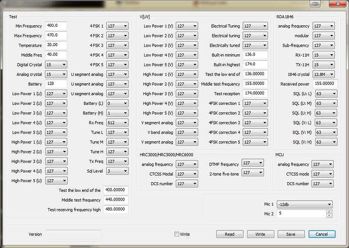

2 things I kind of hate about this radio: 1) the volume control (it’s out of control :P) and 2) the mic gain.
I think I may need to do a hardware mod to tame the volume and I’ve tried the MIC settings in CPS it seems -12 is the loudest but it’s still too quiet in my opinion.
This are just the default values used by the MD software, not values from my radio. I think you’re focused on the wrong part of the picture ![]()

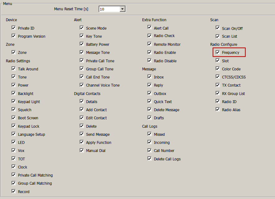

What do you mean by editing frequencies
? In CPS software, there are the individual channels and VFO A/B settings (but VFO only works in frequency mode, if you enable display of channel names, it won’t let you switch to VFOs by holding the “Back” top right key which works in frequency display mode). In radio, editing frequencies of existing channel is possible by Menu → Settings → Program Radio → TX/RX frequency unless you disable this menu in CPS.
Concerning point 2 - do you have the menu enabled in CPS General Settings → Menu?
Best is usually to have everything enabled
Hi people
you can edit manually
you just create two test channels
where you can make changes through the radio
MENU- SETTINGS- PROGRAM RADIO-RX/TX
AND WILL BE HAPPINESS
