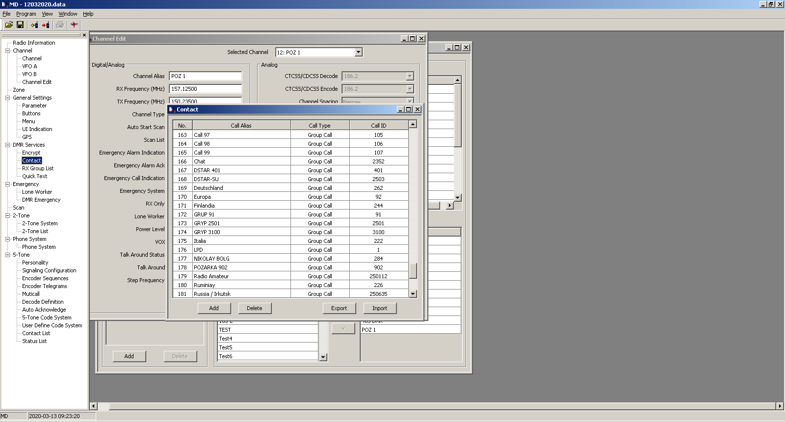

I just want to ask. Do you know what the offer is? When you turn on a station while holding down the Ptt button and the button SK2 below it. What is this setting?
Hello.
This can be said by someone who knows Chinese. But as far as I know, this is test mode. It is probably the same (functionality) as in the MD> Program> Online Test menu. Clarification: You must use CPS2_extra_menus.exe to access this menu.
It seems to be the same design menu (viewed from pictures on the Internet). The software it works with is similar. For the idea, I installed and tried to connect my walkie talkie. It just blinked and restarted. Couldn’t connect.

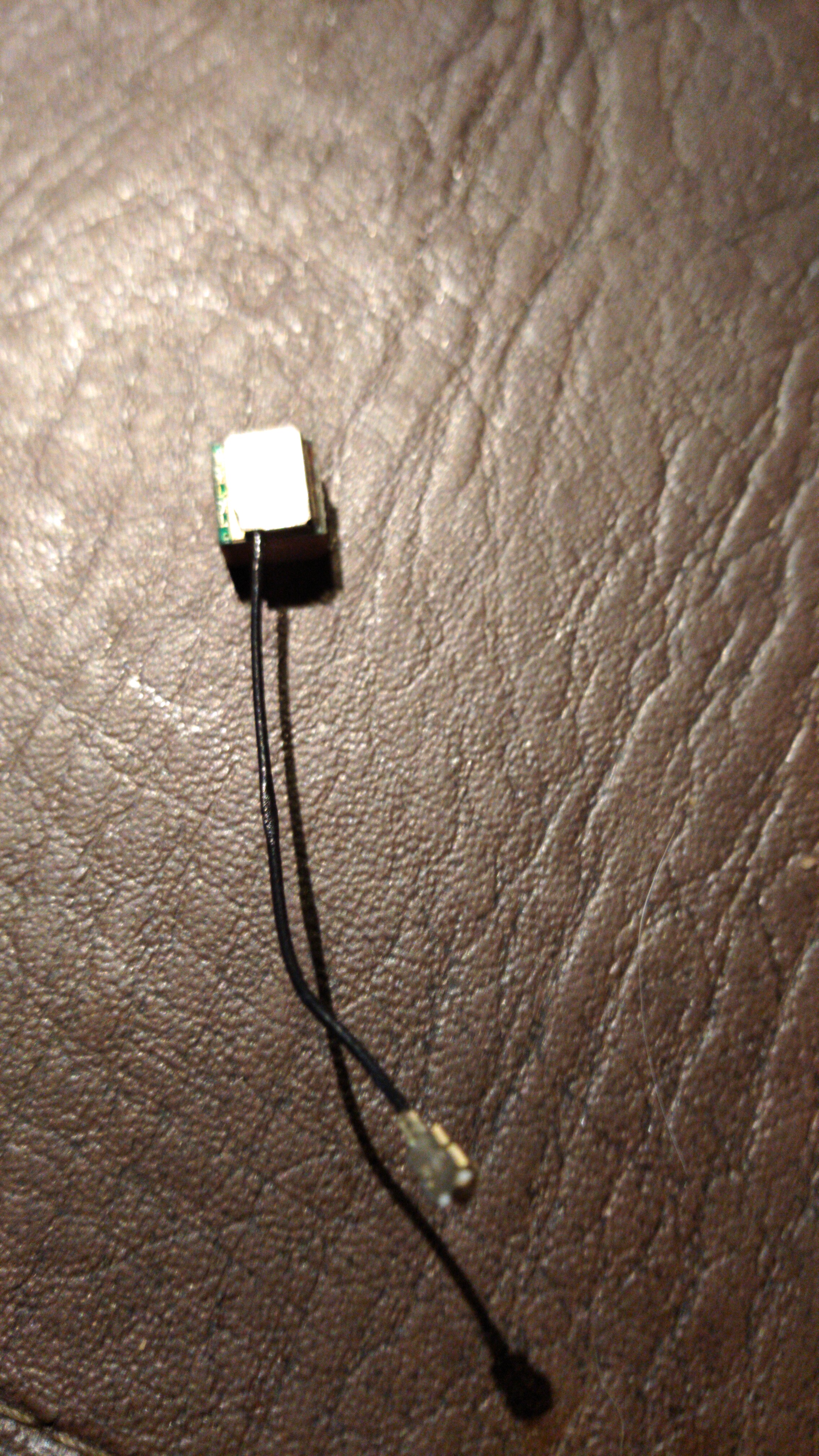

Hello everyone finally found problem in the GPS in this Radio, 1 year later to try to work, not need none settings for work, only need open you radio and found GPS antena located under the circle and remove clean disconnect and Connect again and finaly work Take position after two minutes. Open you radio with carefull, first step is remove the circle metal around volume and antena, open slowly

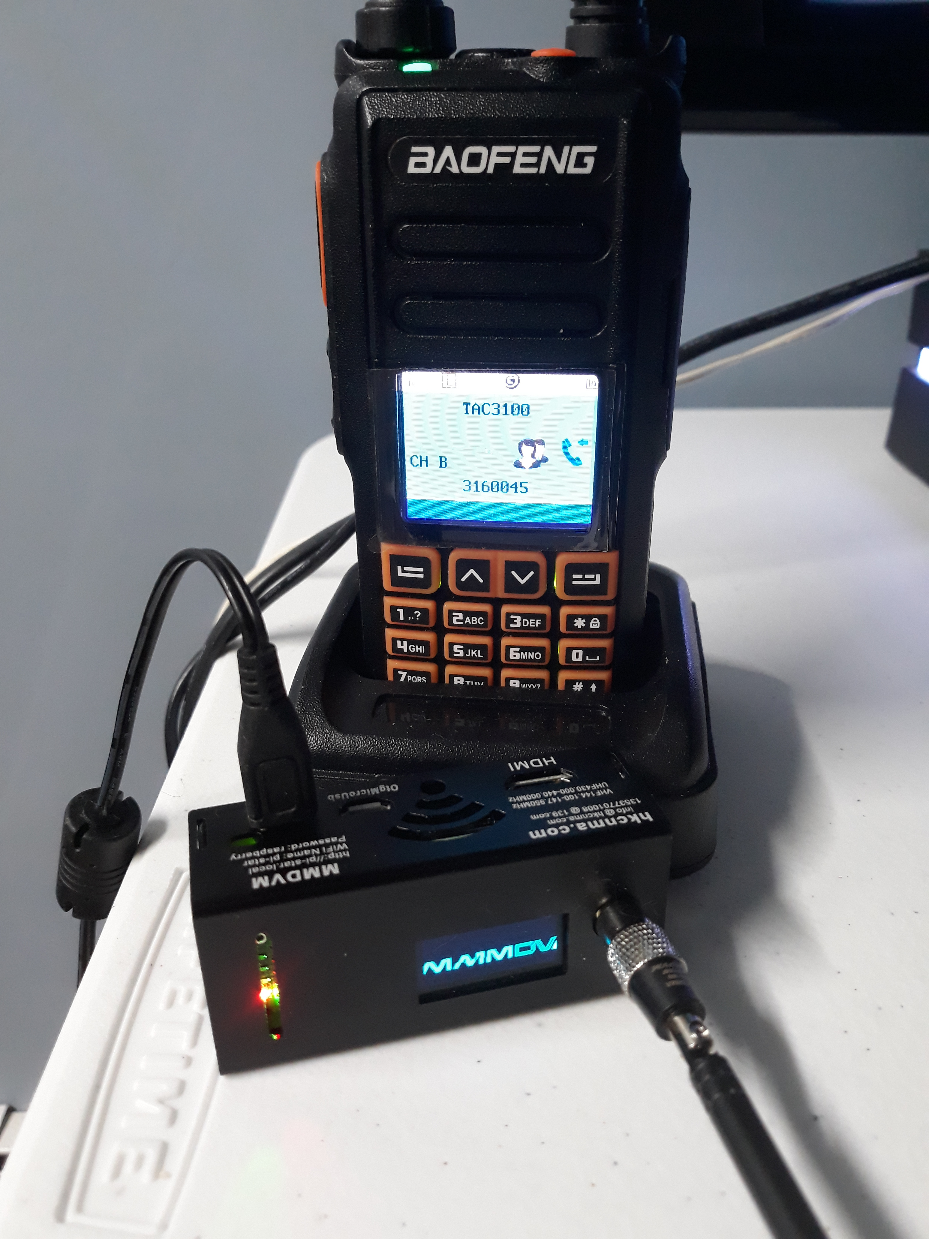

New DM-X owner. I wonder if anyone else has this issue. If I leave the radio monitoring my hotspot for any length of time, eventually it will get stuck on a call. Screen frozen, green light on, no audio. If I hit channel up for down, or either of the menu buttons, it responds fine and resumes receiving. Firmware 2.02.22

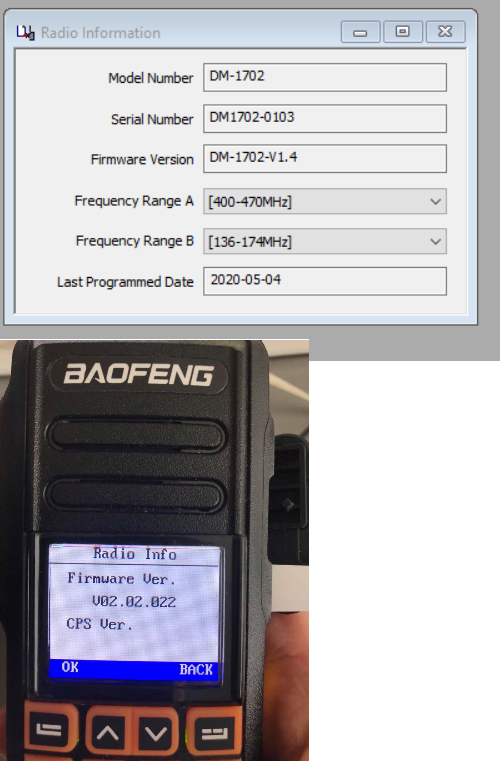

On main board I see “DM-1702-V1.3”
Hello, no it is standard 2.02.022 version, the existing firmware (actually you may enter anything you want to into serial number and other fields in extended CPS settings).
Concerning the customized firmwares, I am quite sceptical to that. I spent quite a lot of time with Ghidra tool last summer trying to identify the individual functions, but a lot of things is different from older MD380 radios in the code (the memory layout, GUI calls, etc.) so the patches would not be applicable. Plus I had to start from scratch for 2.02.019 again and I would have for 2.02.022 as well (although some functions were easy to identify). On the other hand, many things have been integrated to the firmware, like the possibility to turn off the Call/Group matching. The most pressing would probably be the CSV contacts instead of some space used for recordings and I would probably not be able to implement that.
