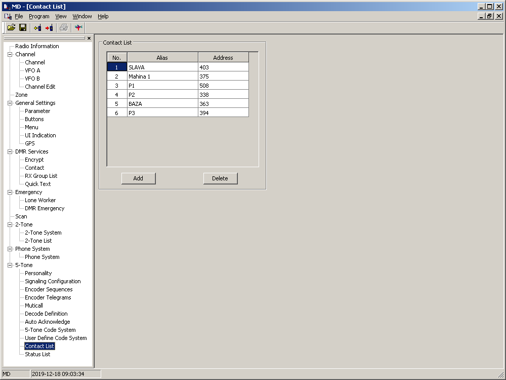

Hello FRENDS
a question
how to specify a group number name
there is a group with different digital numbers
example
300 departure
315- pilot
314- control
when the radio is working, only numbers are displayed (300/315/314)
how to configure to display the name
Hello Daniil.
Where do you see these settings? I don’t see such a thing. Would you share a screenshot?

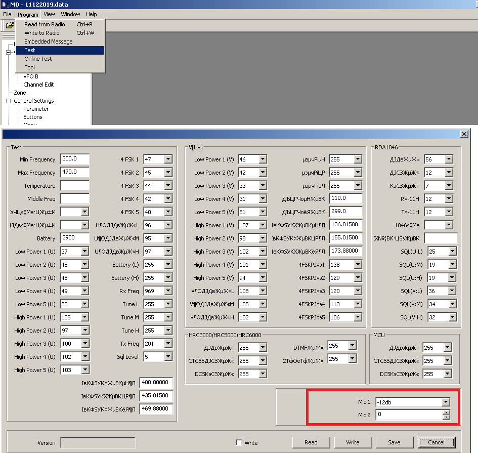

Привет. Всех с наступающим праздником!) Вопрос: Имеются две dm-x, но у обеих слабая чувствительность микрофонов. Можно, как нибудь программно добавить уровень? Не удобно близко говорить или орать в микрофон. Если делать громкость на максимум, то системные звуки, до инфаркта доведут))) Спасибо)
Hey. All with the upcoming holiday!) Question: There are two dm-x, but both have a weak sensitivity of microphones. Can I add a level programmatically? It is not convenient to talk closely or yell into the microphone. If you make the volume to maximum, then the system sounds will bring to a heart attack))) Thank you)
Hello and Happy New Year. Be healthy and happy!
And what’s the difference between the two microphones? Probably one is built into the radio and the other is on the switch (headphones, handset …) What is the value for better amplification?
