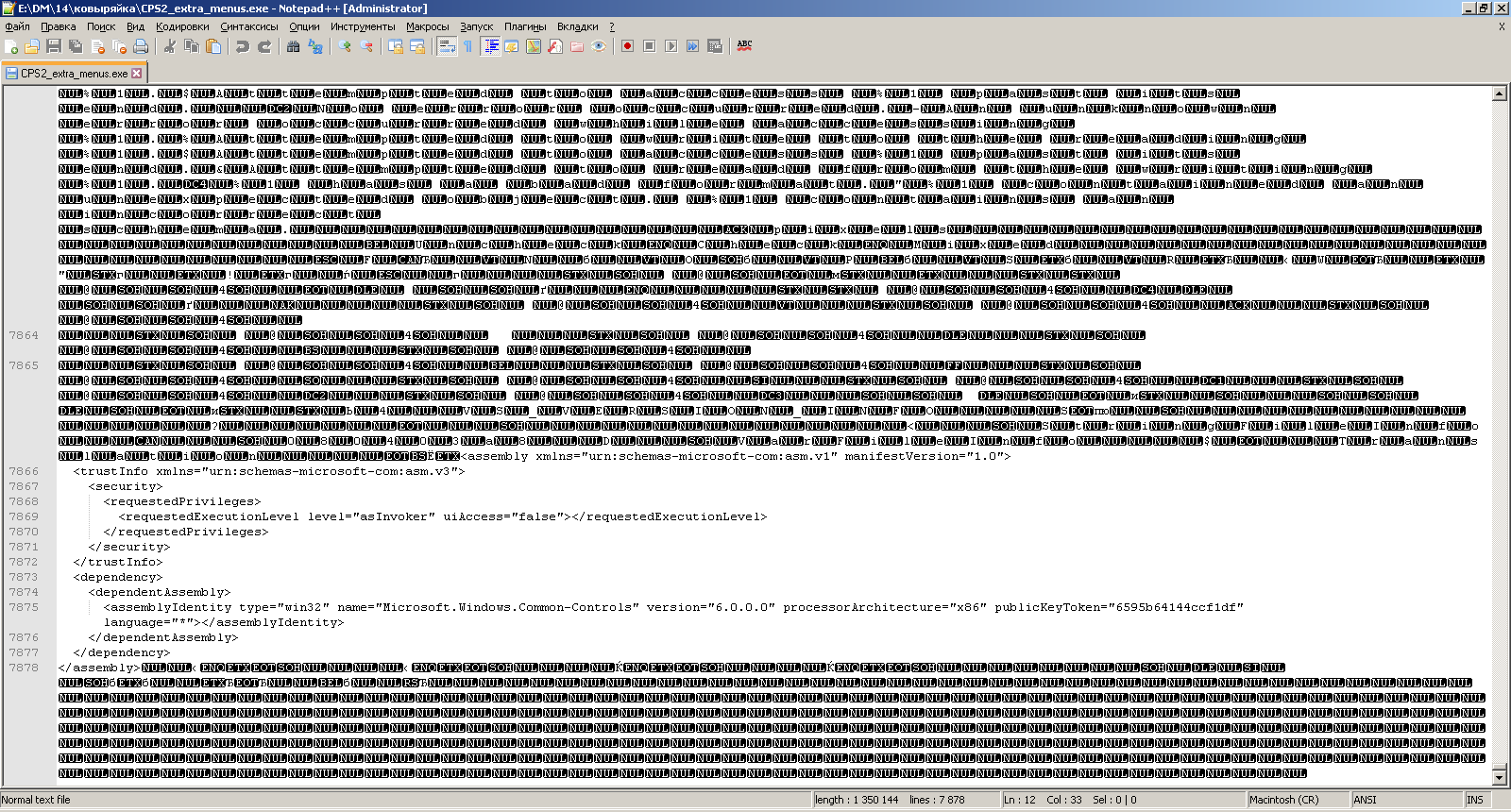

Also, modifying the firmware in binary form is far from trivial. There are no indications what individual things are and thousands of functions. Good luck with that. Also, one does not edit exe files in text editor.

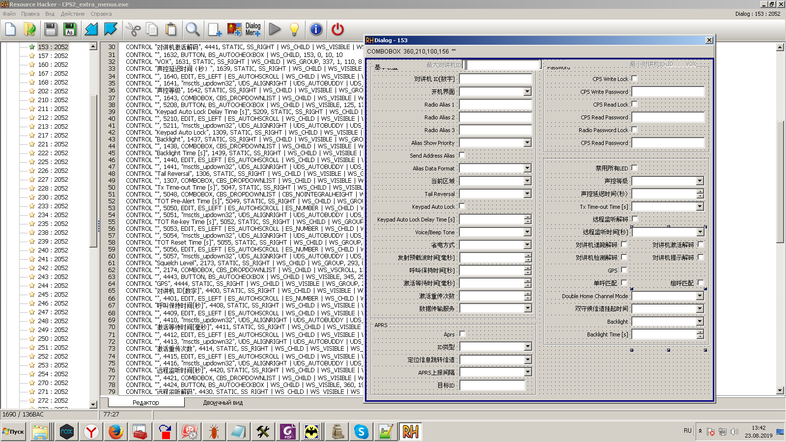

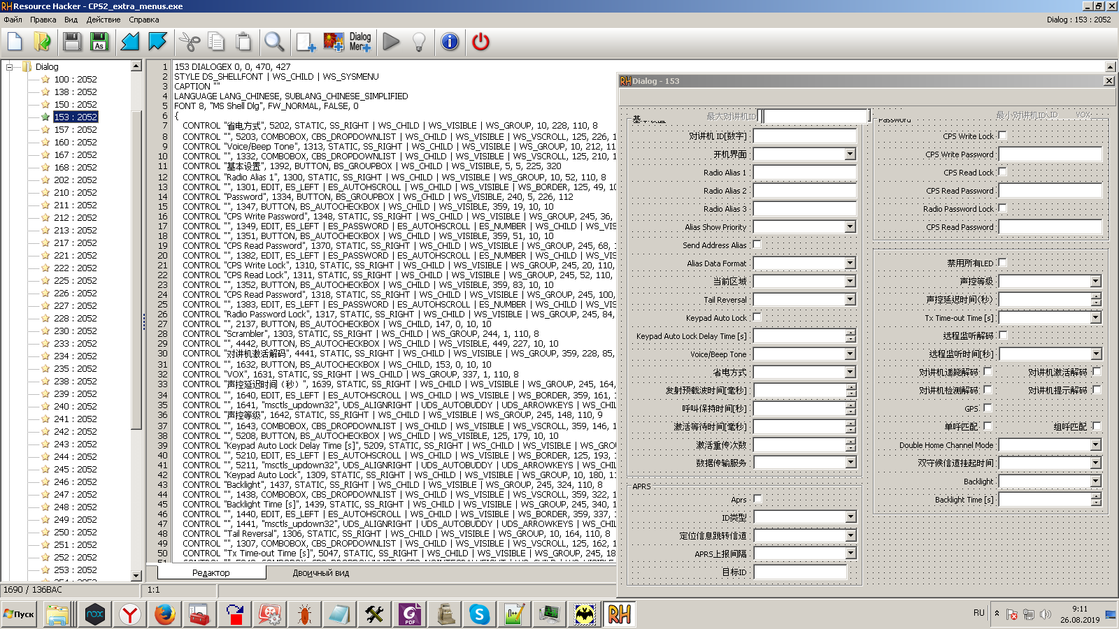

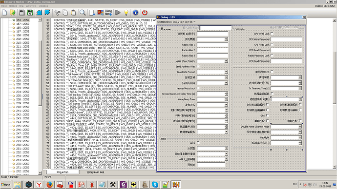

download this program reshacker_setup
it is both in Russian and in English
move the file CPS2_extra_menus
and the program will open the code
it can be changed and saved
(compile)
And does it work for you? Because when I experimented with the settings in 1.0.66, there was no change in the radio behavior regardless if you enabled the settings or not. That is why I did not include this fully-enabled version in my downloads.
Hello again. I have version 1.00.66 on the extra menu. I installed the program that followed your instructions. And this menu with the APRS still does not come out. Would you send me your version of the extra menu?
