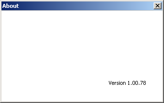

- File from 1702_02_v22-encrypted-CPS-1.0.78.zip - 1702_02_v22.bin* - New CPS 1.0.78
- File from fw_2.2.22-decrypted.zip - 1702_v02.02.022.bin* - Old CPS 1.0.66, Python DFU tool

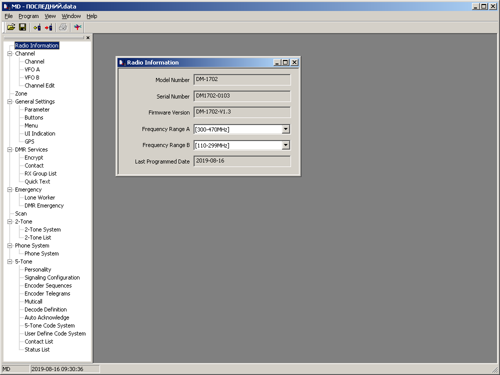

Hello
could anyone
reveal the range
[setup]
language=lang_en
RadioType=MD
BinFile=D:\1702
[MD]
title=MD
version=1.00.78
[modelU]
fdisp0=[300-470MHz]
value0=00000030000000470050998400003001
[modelV]
fdisp0=[110-299MHz]
value0=00006011000040299050990400003001
displays everything but cannot record

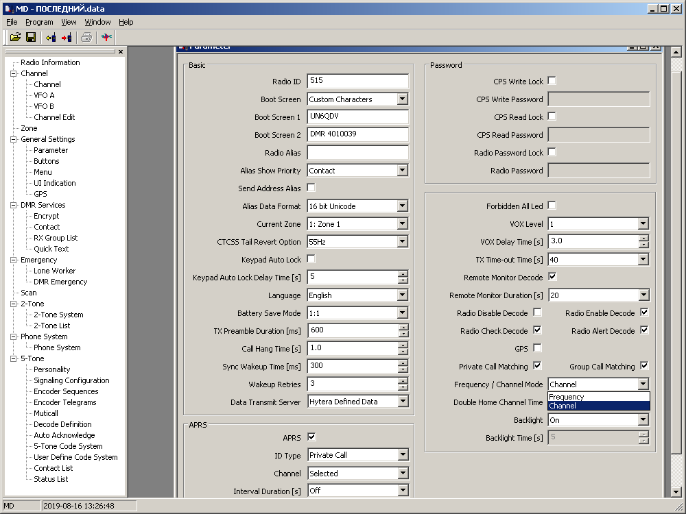

@Daniil: did you also adjust the ranges in the Test mode when you were playing with the setting? And does it work at all (there may be limits hardcoded in firmware)? BTW, I think the hidden 5-tone system implementation is also broken as some settings overwrite data pages of other settings.
In general, I would say the radio is a mix of good ideas and terrible implementation of some parts, some features like switching Channel/Frequency mode directly in radio are missing, you cannot make manual call to a talk group (only through contacts), and other issues I have mentioned in this thread.

I changed the values in the file
but the program does not want to record a new range (300)
it only accepts 400-470 / 136-174
I will still look where to change it
Yes, by the way, the program is written in C ++
who does not have ideas how to do it
Before doing that, I would try to switch the radio to VFO mode and test if you are able to enter the frequencies there. If not, modifying the CPS would probably not help. Also, you could use a hex editor to change the frequency in data file (it is BCD-encoded, I can give you the offset)

You did not understand me. What I meant is for YOU to switch the radio from Channel to Frequency mode and then try to set one of the frequencies you are trying to use on YOUR radio in VFO mode (e.g. 223.49 Mhz) . This way you will know if the limit is in CPS software or in the radio itself

Hello
the result has not changed
cannot enter these values manually too
