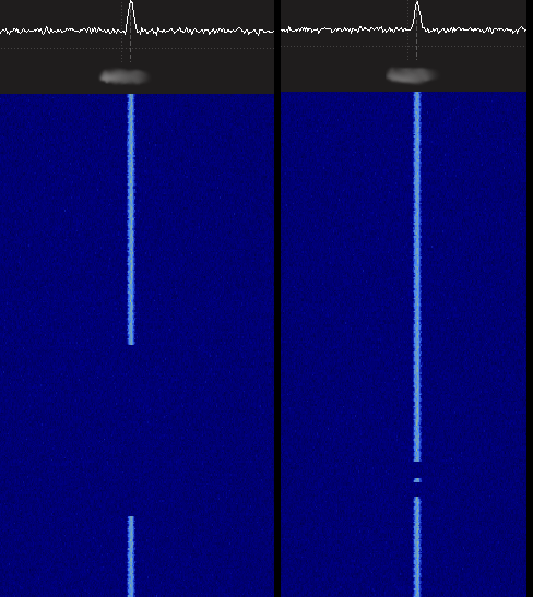

One more doubt when I put a frequency in any digital mode I get the signal lights green but the audio does not come out of the modulation, what could it be?
As I mentioned, green light (and Green A or D sign next to channel) indicates presence of signal. But it does not have to be the DMR signal. You could try to create analog channel for the repeater frequency and listen on it if you hear anything (ideally in monitor mode).
There are generally 4 possibilities:
- some other signal, e.g. ASK/FSK-modulated wireless sensor for a weather station or other 433 MHz ISM device (this happens to me quite a lot)
- analog signal on the repeater
- D-star or other digital mode unknown to the radio or a DMR signal with so bad BER it cannot be decoded or DMR in Talk-around mode, which uses different encoding scheme.
- DMR signal, but a private call for somebody else/group call for some group you did not list (you can switch the private and group call match setting to enable monitoring them as well)
I would suggest using SDR (e.g. RTL based SDR) USB sitck on computer, tune in the frequency you are talking about and look what happens. DMR signal has quite specific signature
