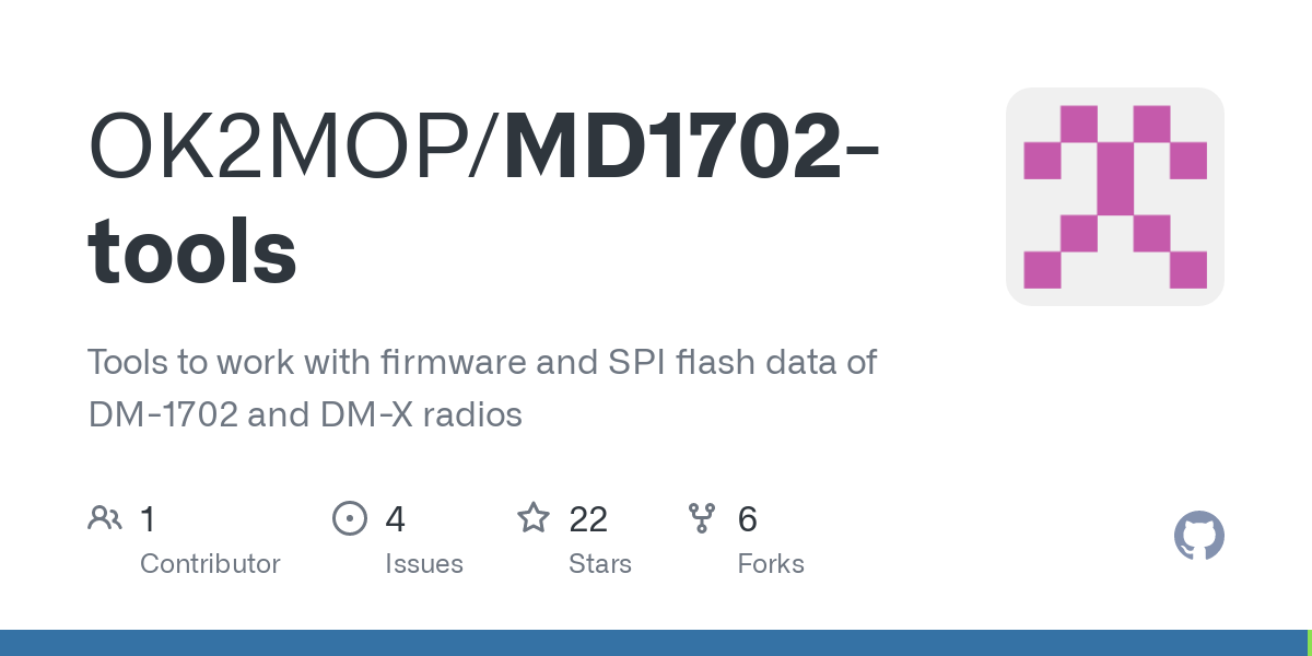

for people who complain there is not enough progress, I have some good and some bad news. I made some progress reading/writing data (including logos, audio recordings, voice and Chinese font) in Linux, and created something similar to md380-dfu. Plus I made a converter to make it possible to convert logo graphics to png and back. The results are in
But for the recordings, you will also need a patched variant of dsd to decode the recording files, see README.md in the repository.
If you wish to, you may try them, they should work both with python 2 and 3, run the scripts without parameters to show help.
But the bad news is, I am not able to work with the codeplug, just back it up and restore later, not use the .data files. Plus the description is very basic, for Linux users with experience. I left for holiday, so I probably wonāt be able to change it for a week or so.

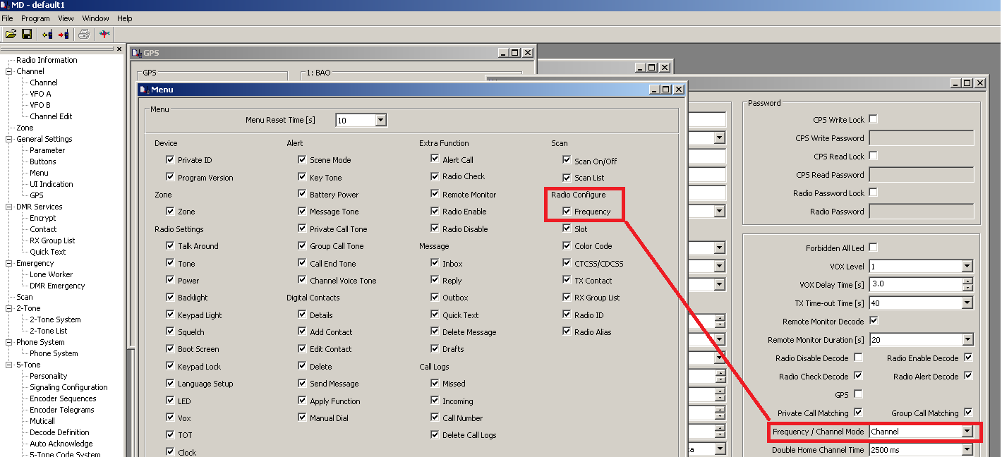

Does anyone know how to get it display channel names (Aliases in the software)
instead of just frequencies?
Am I missing a tick box in the software?

the Channel names can be set by setting Frequency/Channel Mode to Channel in Parameter (General settings) in CPS, but not directly on the device

Thank you SO much, i knew it had to be there somewhere but i couldnāt find it, you took me straight to it, thanks again.

Guys I found the function of switching the VFO
but she is not in the radio station
it is not displayed in the radio station and cannot be activated because of this
Thanks for that, yes it seems to be Mem OR VFO and no way to switch on radio.
Not a huge problem I guess, but would be nice if you could select via a button.

The frequency radio configure setting is for enabling the menu which allows changing frequency of existing channel stored in radio, not for switching Ch/Freq. mode.
