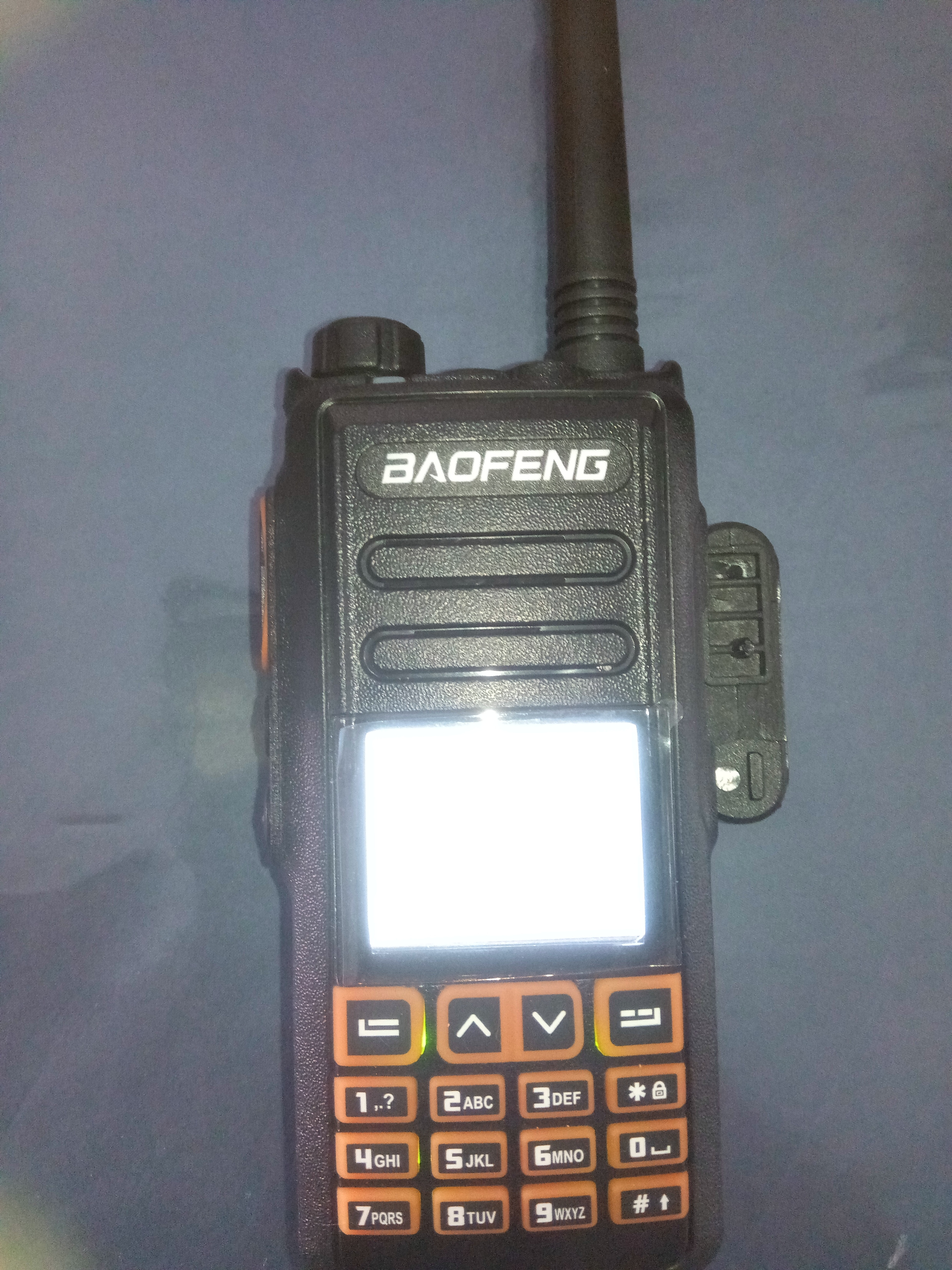

I have followed the procedures you have edited but nothing to do. The screen retes desperately white!
The radio is well recognized in writing and reading by the program in the “embedded message” mode
The update passes correctly and I ticked the boxes exactly as on the image.I am lost …

concerning the white screen - did it happen after firmware upgrade or was it not connected to it (I am a little confused from the original message)? If you are able to communicate with the radio via USB in CPS in settings upload mode, the firmware is working. I would rather suspect a hardware issue in this case, like the one I had (but in my case the display had this pattern of red/green/blue noise in the startup).
What happend to me after using the radio for about a week and half: when you look in the early posts of this topic, you will see there is a ribbon cable connecting the main board with the board with LCD display/buttons. In my case, the casing of GPS damaged the ribbon cable and it stopped working, it could also become undone if not properly latched. I used one from Orange PI offical camera for some time in my case and in the meantime I received a batch I ordered and replaced the one which was broken. But this is just a guess.
Also, if it was a problem with settings, I would back the original one and then load the official blank setting from the CPS data folder and try to flash that.
The embedded message fix should only rectify issues with Chinese font, button audio names, and missing start-up picture, the rest functions OK.
