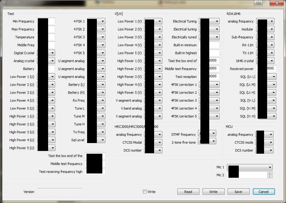

Set battery value at 2800, don’t go under. Do NOT use the “Online Test” - just only the normal “Test” as in the picture at top. Read data from radio as usual then read again in this “Test”-menu, at end mark “write” and write. Save to close menu. Make print-screen or camera photo as backup!!!
Well, using MD-CPS 1.0.78 with extra-menus.

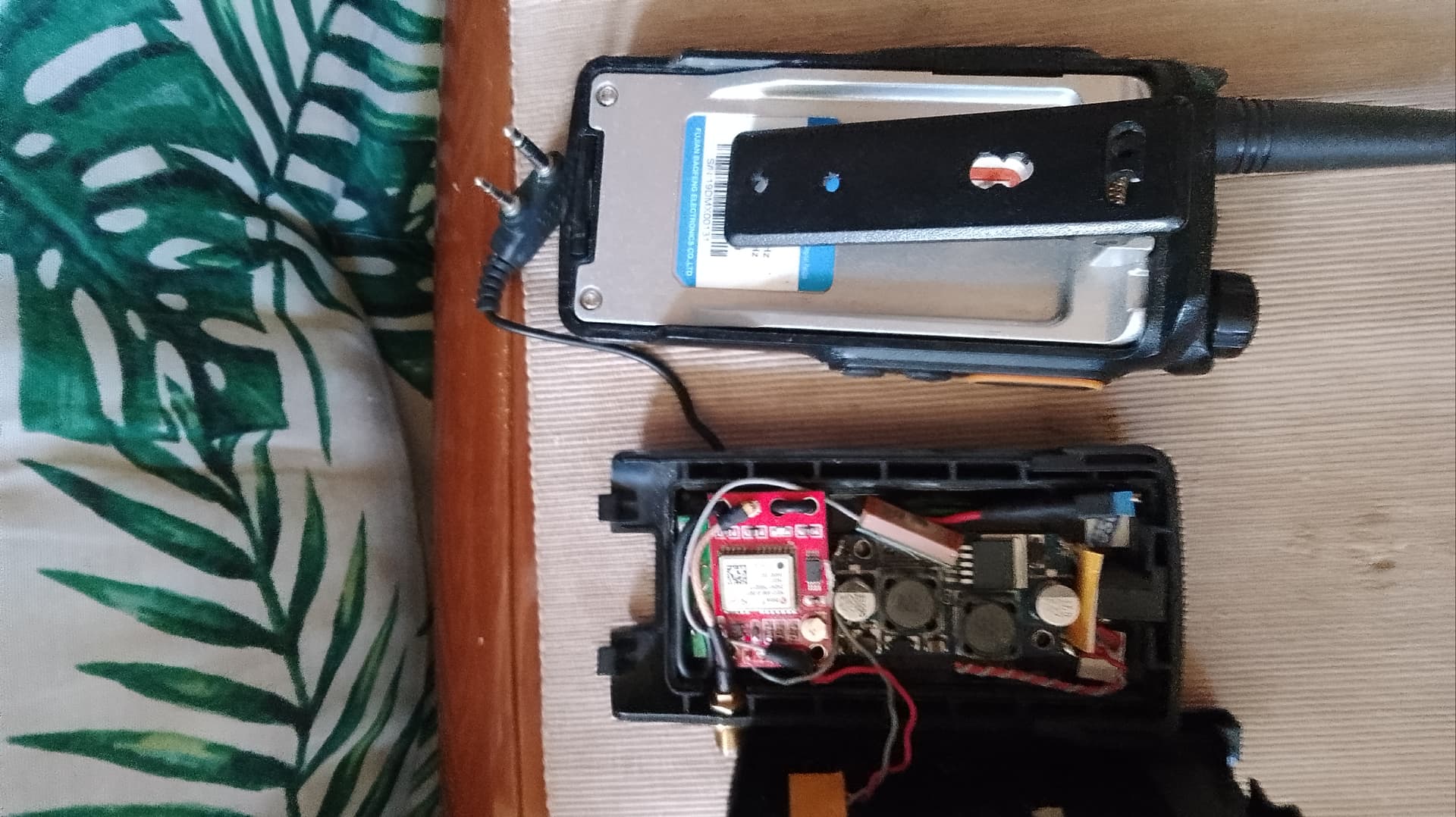

Although it is my first radio, I keep it and use only as an analog APRS (after reworking the battery cover with pulse feeding 8-32V / 2A and APRS board module.
