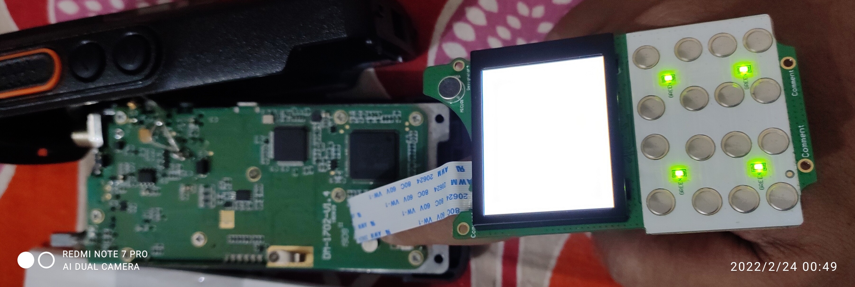

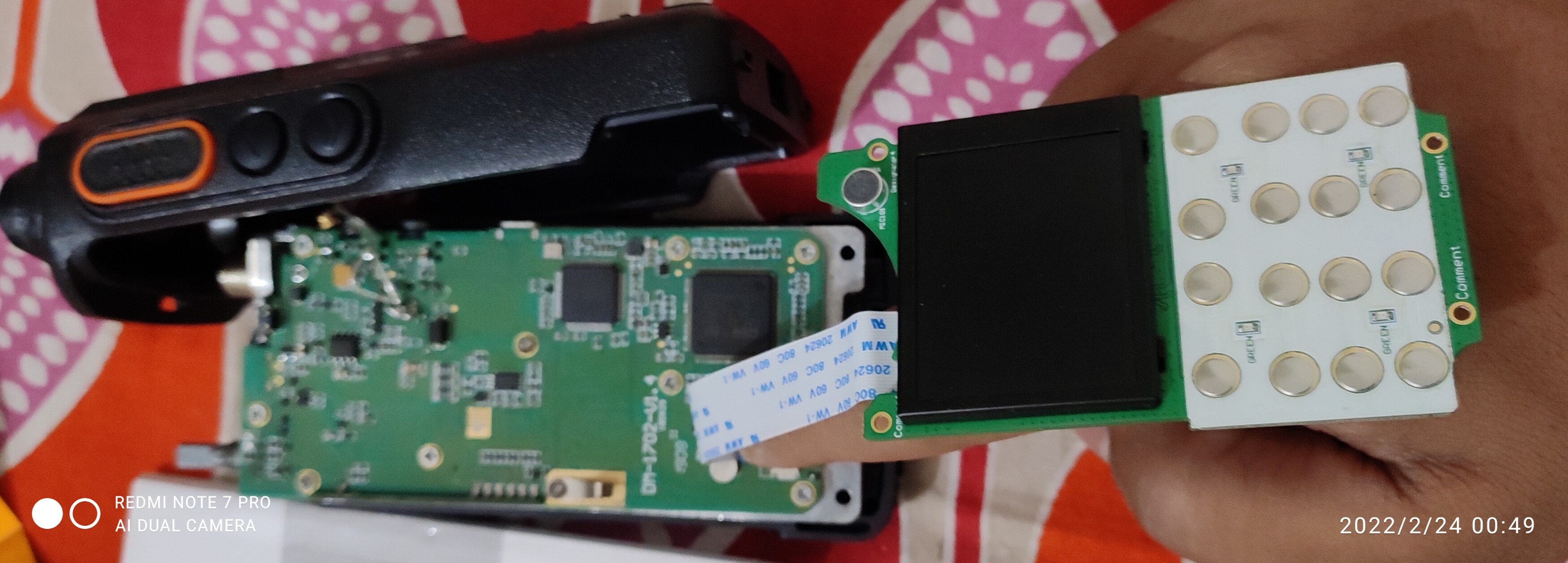

Have you find any solution for this. I have also same issue. White screen.
Link not working while trying to download

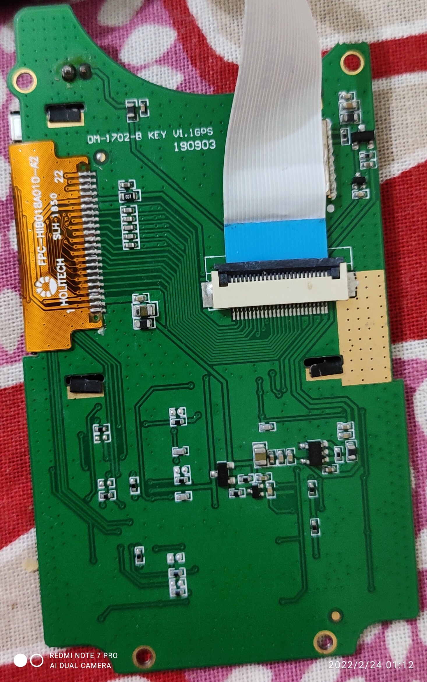

I’m pretty sure the problem with the white display is hardware. The ribbon cable does not come into contact with the jacks.
I tried with contact cleaner but no luck. Also in my case ribbon is only from mainboard to key board no other ribbon… Display ribbon is directly solderd
Hmm. I don’t think it’s ok to solder it directly. But the fuxxxing Chinese decided so. Have you tried an old firmware version?
