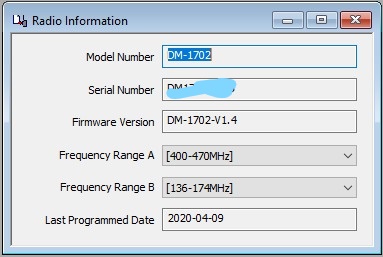

Firmware version is:
InkedF
and no GPS on the menu at all, that option is missing
I’m working right now. In 4-5 hours I will look in detail and write to you. By the way, this model of baofeng is my first walkie-talkie. I replaced it with Anytone 878uv. Anytone allows 98% configuration of itself.
