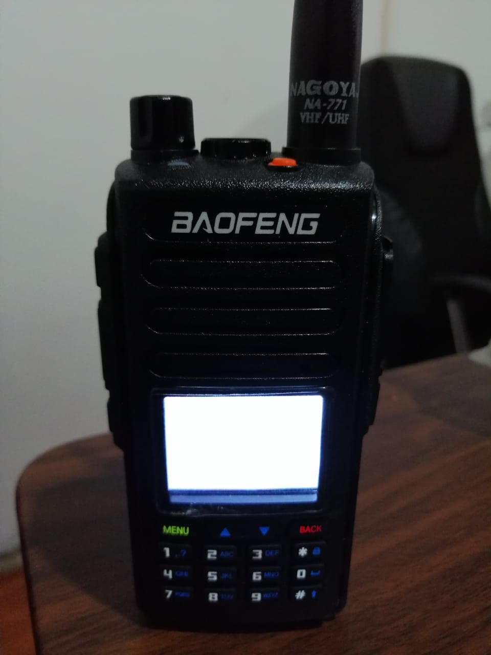

Hello everyone, I am from Chile and I bought this radio from China and when I received it, I looked for a way to program it, here in this forum I found the solution with the ch-6dmr program, but after a few days without use, I have used it again and I find a white screen and I don’t know how to solve this problem. I hope to receive help from all of you.
I have a baofeng Model MD1702-04000-V2
Firmware version DM-1702-V2.2 (L05.01.005).
I apologize for the translation I have used google translator

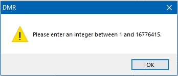

Hello!
I bought another DMR radio and decided to add additional 2 digits to my SSID. But i can add only one (8 digits max) and CPS shows an error, if i try
ssid_err
Hi, what is another DMR radio?
Kydera 300UV. Does it matters?
Hello. It matters. It just got interesting to me. Some radios are older or with older firmware and the maximum number of characters allowed is 8. I’ve heard that this can be fixed by updating the firmware or patching. Probably the manufacturer or trader can help you
We are talking about Bao DMX here. And I have latest firmware
By the way, now I checked (on Baofeng) with me. It’s the same way.
I tried on my second radio Anytone 878UV+. It also cannot accept more than 8 characters.
Unfortunately, I do not know what can be done. Who knows let us know. We are certainly not the only ones who have this problem.
It is really strange to me that relatively new stations have this problem.
I wish you success!
