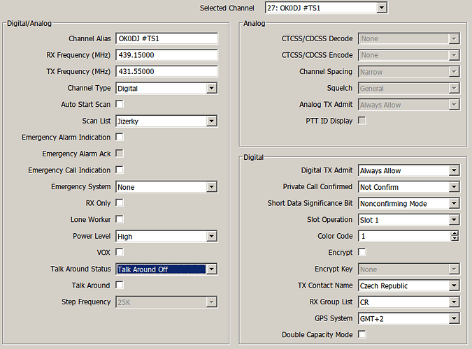

Since you did not provide the screenshot, here is an example of what my working configuration for OK0DJ timeslot 1 looks like

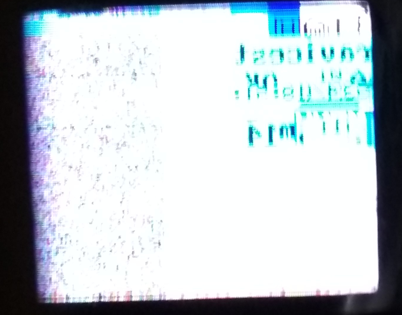

just a warning, if you have -V1 device with GPS (DM-X), it is highly probable at some time your display will stop working and display a RGB noise pattern or some strange things like you can see on the first picture (somebody reported fully white display, but it might have been different issue). Both of my DM-X radios “died” this way, the second one I gave to my mother just as I was away and wanted to make a QSO with her.
Example of faulty display (sorry for the quality, I was not the one to take the photo):

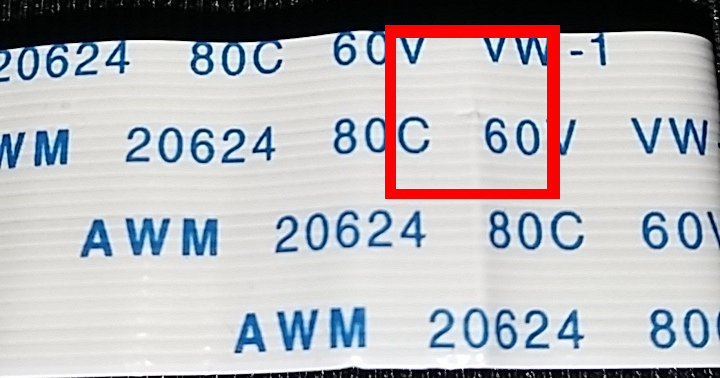

The problem is that the GPS module casing pushes against the ribbon cable and after some time its corner breaks one of the leads in the ribbon cable:
The solution is simple, you have to disassemble the radio (it was described earlier in this thread - 2 bottom star screws, remove volume cap and antenna and unscrew the rings, pull on the rubber of the connector cover), carefully unlock the ribbon cable connecting the two boards (not breaking the speaker wires) and replace it with a new one.
I was not able to order same length, but I successfully used one from OPI camera temporarily and then ordered 0.5MM / 100MM / 24P / A-Same Side contact / AWM 20624 cable (had to order 10pcs in China, but the total for all of them was around $2). Any reasonably long (8-12cm) 24-pin same-side contact AWM 20624 cable should work (i.e. the contacts on both sides are on the same side of the cable).

I did not take a photo when fixing the second -V1 device - I may check if I have some older photos - but the inside photos were posted by someone else in the beginning of this thread. Anyway, replacing the ribbon cable means carefully lifting its (gray) locks, pulling the cable out, pushing the new cable in (blue side on top), and re-locking the locks.
