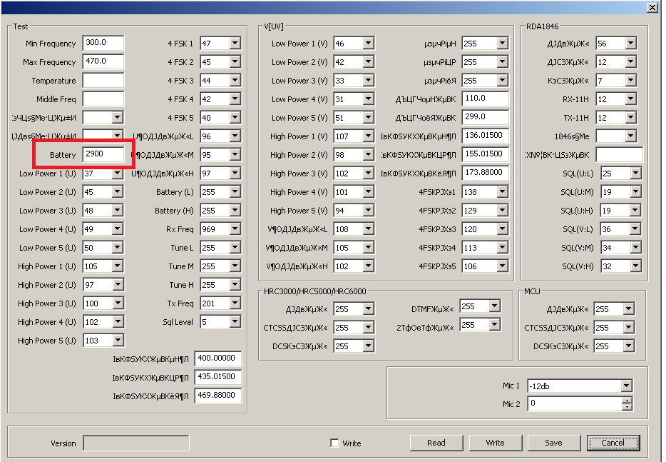

The battery can be configured here

I am with this parameter
set the correct display of the battery
