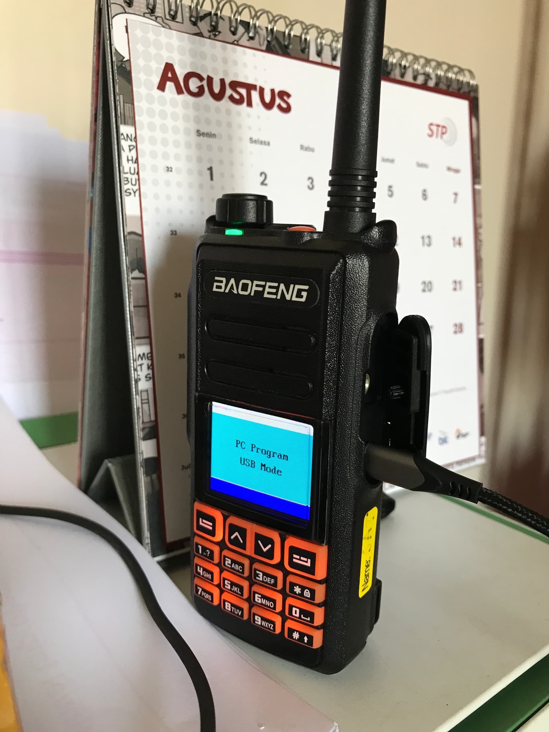

I have an issue with my new radio Baofeng DM-1702 gps… On it was a firmware L05.01.005… I 've tried to change it to version [FW V02.02.023] with CPS v79 “chinses ver.” after that the radio did not start up… when I try to turn it on, it does not work. It works only on DFU mode (# + POWER)…
Help me pls to make my radio works again…Thank you very much…
For anyone struggling with L05.01.005:
anonfiles com/h0M5YaE6we/1706_zip
Delete VCP driver or reinstall as printer and reboot before use! Radio should be recognized as printer device. The password is “baofeng”

After took a brake, I tried again to find software for my baofeng L05.01.004. I installed one that was suggested in this web using software for CH-6DMR(IC) and it worked …
yeey…
wow! so, finally which firmware did you use? can you please send me a link to that firmware…
CH-6DMR(IC), you can download it here Support & Download – Baofeng Radio Canada
thanks! I have the software allright, my question was about the firmware - the BIN file.
Radio Baofeng DM-X, Firmware L05.01.004 (It came with the radio, I did not change)
Previously I tried to use any programming software for DM-X or DM 1702 with no luck.
