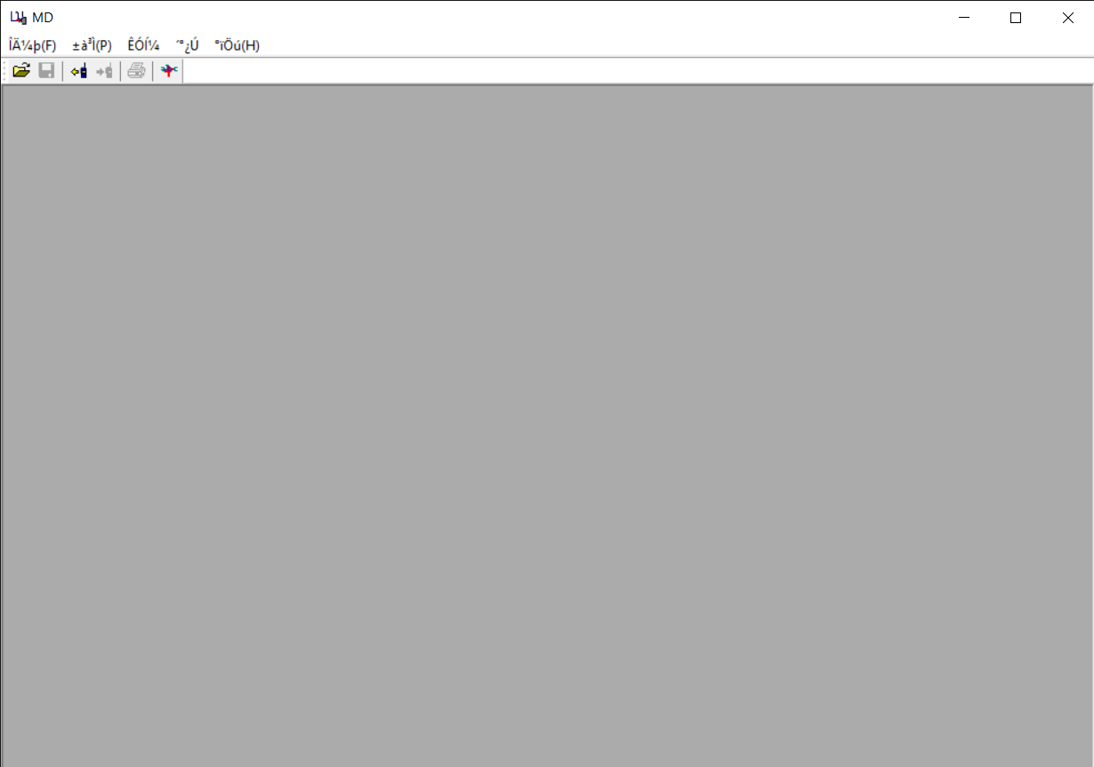

Hi, new to the forum and HT units. I received a Baofeng DM 1702 for Christmas. Trying to program the unit. I’ve downloaded a couple of versions of programs for the Baofeng site and a couple of others. If I can get the app to install, when I connect the 1702 to my Windows 10 computer and try to read the radio data, I get a message saying the read failed (thanks, I kind of noticed.) The screen lights and flashes the unit is in PC Program USB mode. The green indicator light on the 1702 flashes twice. When I check device drivers in Windows I see a printer device driver associated with the 1702 - it says no printer attached. Same results with a USB cable or the programming cable that came with the radio. I’m looking for any help anyone can provide. Is it possible that the unit is defective? HELLLLP Please. Thanks in advance.
It’s almost certainly Windows doing it’s thing. The first thing to do is to try it on as many computers as you can. I’ve never yet found a faulty radio - but the USB interface is endlessly random in success. For my radio programming I have got quite used to X working on one computer with another working only on a different one. Windows has a habit of really getting confused, and if it thinks the interface is a printer, it’s certainly confused. Sometimes one install of Windows 10 will constantly replace the correct driver with a non-functioning one it determines is the right one, despite you saying it’s not. The CPS for one popular radio has been known to totally refuse to work with one Windows install, and the solution was to use a totally wrong CPS, which read it and can write to it. One customer thought he’d bricked the radio and tried new firmware and all sorts of internet suggestions but I supplied another radio and it was the same. He returned both, which read perfectly well on my computers. Sadly, this is normal.
I’d certainly try every computer you can get access to - and I bet you’ll find they’ll work. The 1702 and a couple of others all use similar CPS versions - daft really, but how it is.
Thanks for the advice Paul. I’ve tried both the 2 plug cable that came with the radio and a micro USB. I will try a different one. Also tried this on 2 different W10 computers. The right device driver is installed when I plug in either cable, but I get an error message when I attempt to READ the radio and any other options are grayed out. And daft is a good word to describe the situation. For the life of me I can’t find and english language version of the 1702 CPS program. Tried the 1701 program but no love there. Well, back to search. I feel rather Don Quixoteish.

It’s a total pain - in the main, I blame Windows - My PC in the office with Windows 10 and latest AVG, quarantines every CPS software I install while it double check with AVG - I guess it is the writing routines in the zip file they’re normally supplied in, but my PC at home, with the same software doesn’t do it!
Fingers crossed you get there! Paul
Well I have tried it on two different W10 machines. My laptop has AVG on it and it does make it a challenge sometimes. I appreciate the attempt to protect me from myself, but really! My wife’s desktop has little anti-anything software on it and we get the same errors and results.

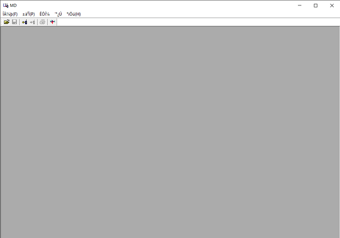

So, I downloaded your file, so full of hope - angels sing, things like that! Program loaded up fine, I think, you’ll see my reasoning in a minute. I plug in the radio, turn it on, look in device manager and there’s the driver. Fire up the program and click on the read radio icon and disaster ensues. Well not exactly disaster more like shattered dreams!
I have one or two other things to try and if unsuccessful I’ll return this. My current replacement plan is to drop DMR and go analogue for the moment. I have my General and could go right to HF, but being a pensioner I need to save my pennies first. I have a very nice set of repeaters nearby that I can hear just fine on my Radio Shack (a name from the past. Of course I worked for Digital Equipment Corp and Compaq Computers, both names from the past) Pro-90 scanner. If I do that, I’ll go with either the BF-F8HP or the UV-82HP (I assume there is some logic in product naming, but again, I might be disappointed.

Happy end of 2020!! On the cable side of things I have tried a couple of things. I did get the radio with the cable from them. When I plug this into my Windows 10 computer and turn it on, a drive, not the Prolific or FTDI driver opens and makes noise about no printer. Based on my searching around this seems to be the expected behavior. I’ve also tried a couple of micro USB cable and get the same behavior when connected.
I’ve downloaded SO MANY version of software that claims to be for DM1702B that I received a cease and desist order from my computer. For a while, I too feel victim to the lame-■■■ process to read the data from the radio. Once I figured that out, I’ve never been able to get past clicking on OK and getting an error message. It is interesting that the screen on the radio does popup a transient message about being in PC programming mode, but it seems to get over that quickly.
