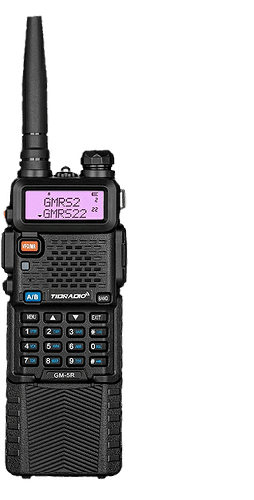

This is GMRS radio I ordered
Is a UV-5R radio able to be licenced on GMRS? I’m a brit, so not sure of your new rules, but I thought they were on the naughty list now? It’s surely a rebranded Baofeng, and the Amazon adverts say it’s legal - but if Baofeng can’t get the radio through the Part certification, how does Tidman?

No the uv5r is not allowed to broadcast on gmrs frequencies
You can listen.

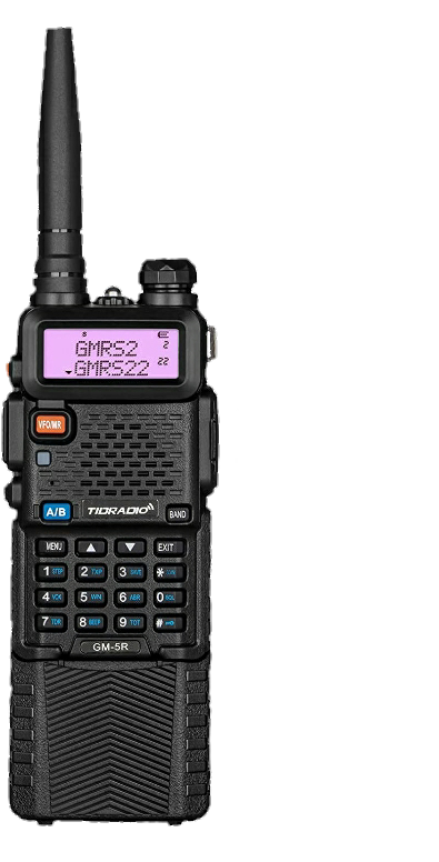

What I have is GM-5R GMR
And next month I applying for my fcc 70$ license and talk on it
This is completely bonkers! You could have bought a two UV-5Rs for the price of the licence. GMRS radios do NOT need any of the kind of features of these radios. If you want to play with gadgets and gizmos and try things out - then get a ham licence. You still do not understand what FRS, GMRS radios are all about. ‘High dollar’ radios cost far, far more money than these entry level leisure radios. Your Government set rules and people are attempting to get around them with these ‘new’ radios. They set specifications - Part 90, 95 etc and there are lots of people testing these new versions of the Baofengs and concluding that they are better than the old UV series, but still don’t meet the spec. The evidence that they do is feeble to non-existent.

Features led display

The FCC ID for this radio appears to be 2AWL3-GM5R. This has been approved (7/29/2021) under multiple certificates including 15B and 95E, where the latter is GMRS.
The FCC certification is granted upon submission of the required testing reports and certifications by the independent MICOM Labs, of Boulder, Colorado. You can review the files in the FCC’s online database at the Office of Engineering and Technology. Yes, it’s possible to submit false information in federal applications, but it could also be a federal felony.
Upnorth - I’m not quite reading this correctly I think? In the US, I assumed that you just had to meet the regulatory body’s spec, like we do here. Our equipment must meet the standard, but do the US require a physical test of a radio, or do they just read the independent report from a 3rd party. If I’m reading it right, MICOM receive radios and submit finding to the FCC, or do MICOM receive reports and just submit them?

Yes, MICOM or other approved test labs do the testing and rules conformance documents (operating modes, etc). They or the client submit the findings to the FCC for review and approval. Here is a link to a summary of the need for Equipment Authorization and to the Procedure for that at the FCC. “Except when otherwise stated in a rule, an intentional radiator (transmitter) is required to be approved using the certification procedure.”
The good news then is that Baofeng have managed to add some filtering to the old designs so they meet the standards enquired, which sounds good, as they did have lots of spurious outputs. Does the spec they need to meet also cover their receive performance or is it simply looking to prevent interference to other services?
