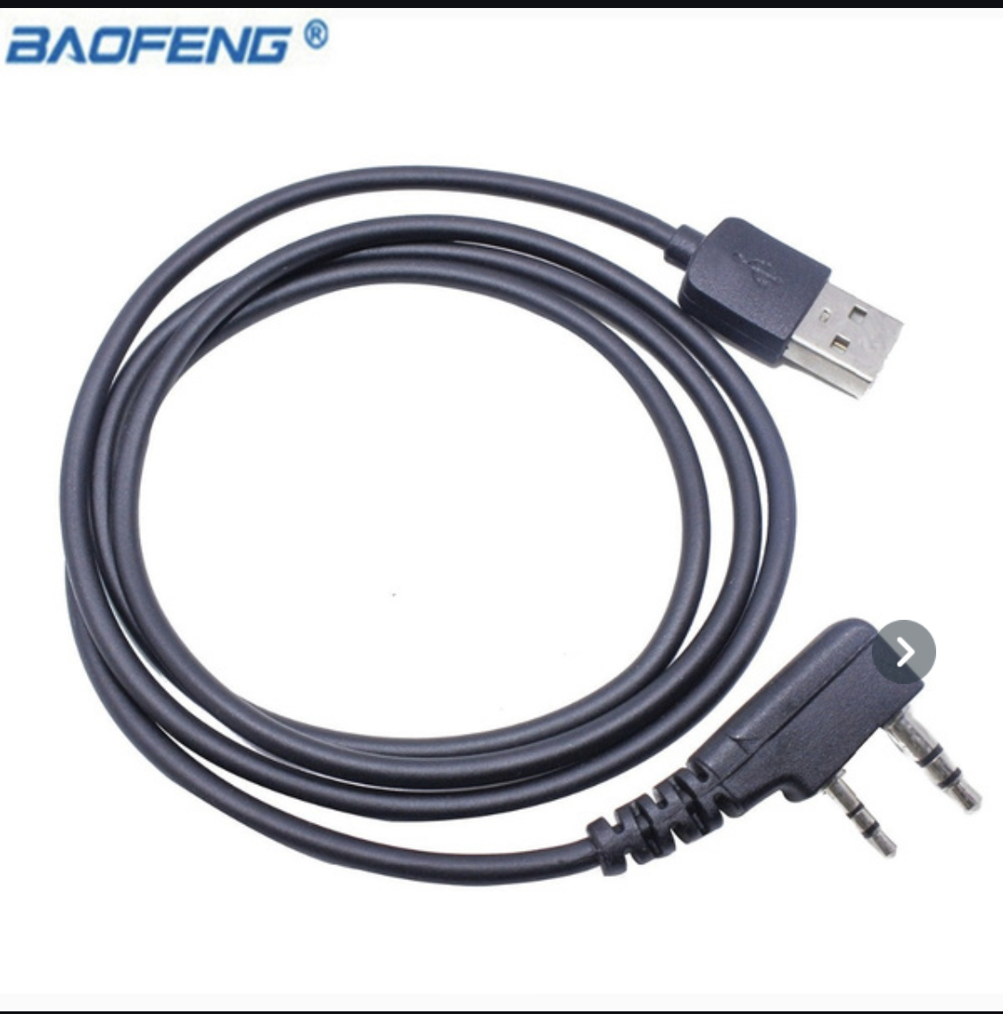

Is it worth it to try the advertised programming cable ?? They market it like this.
It is only for BaoFeng DM-860 DM-1701 DM-X Tier II DMR radio
Main Feature:
Support Win XP/Win7/Win8/Win10
Compatible with BaoFeng DMR Tier I & II Walkie Talkie
Package :
1 X Programming Cable
That’s the USB-2pin cable that was missi g on my kit as supplied, so yes worth a try, although it sounds like you’re where I was.

My cable came today the 2pin (pictured above). Shockingly enough, it still doesn’t work. It’s behaving the EXACT same way it did when I used the microSD cable instead. So, thinking it was the cable was obviously another 20$ mistake.
