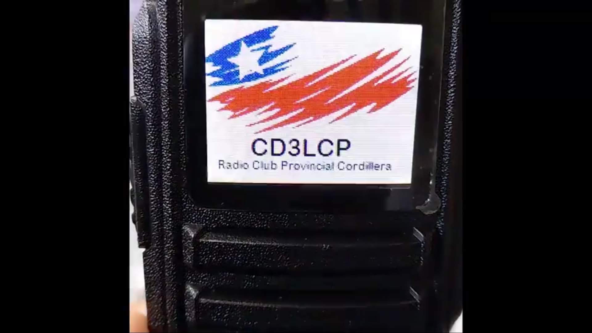

HI All: anybody have an idea how to change the boot Image of the radio? there is a dealer in chile than actualy personalize the radios with a flag on the boot screen of his radios. I
Any Idea?
