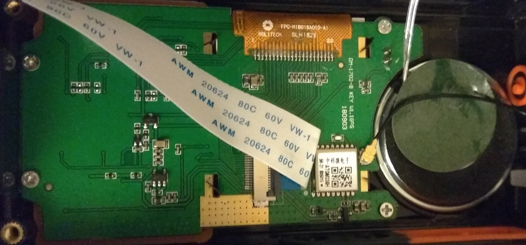

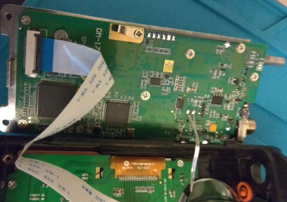

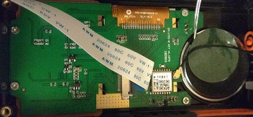

I did not take a photo when fixing the second -V1 device - I may check if I have some older photos - but the inside photos were posted by someone else in the beginning of this thread. Anyway, replacing the ribbon cable means carefully lifting its (gray) locks, pulling the cable out, pushing the new cable in (blue side on top), and re-locking the locks.
The number of contacts (pins) as well as other parameters were mentioned in my previous post - 24 contacts to answer it again.
EDIT: Here are the photos from the first fix, when I used a longer ribbon cable:
