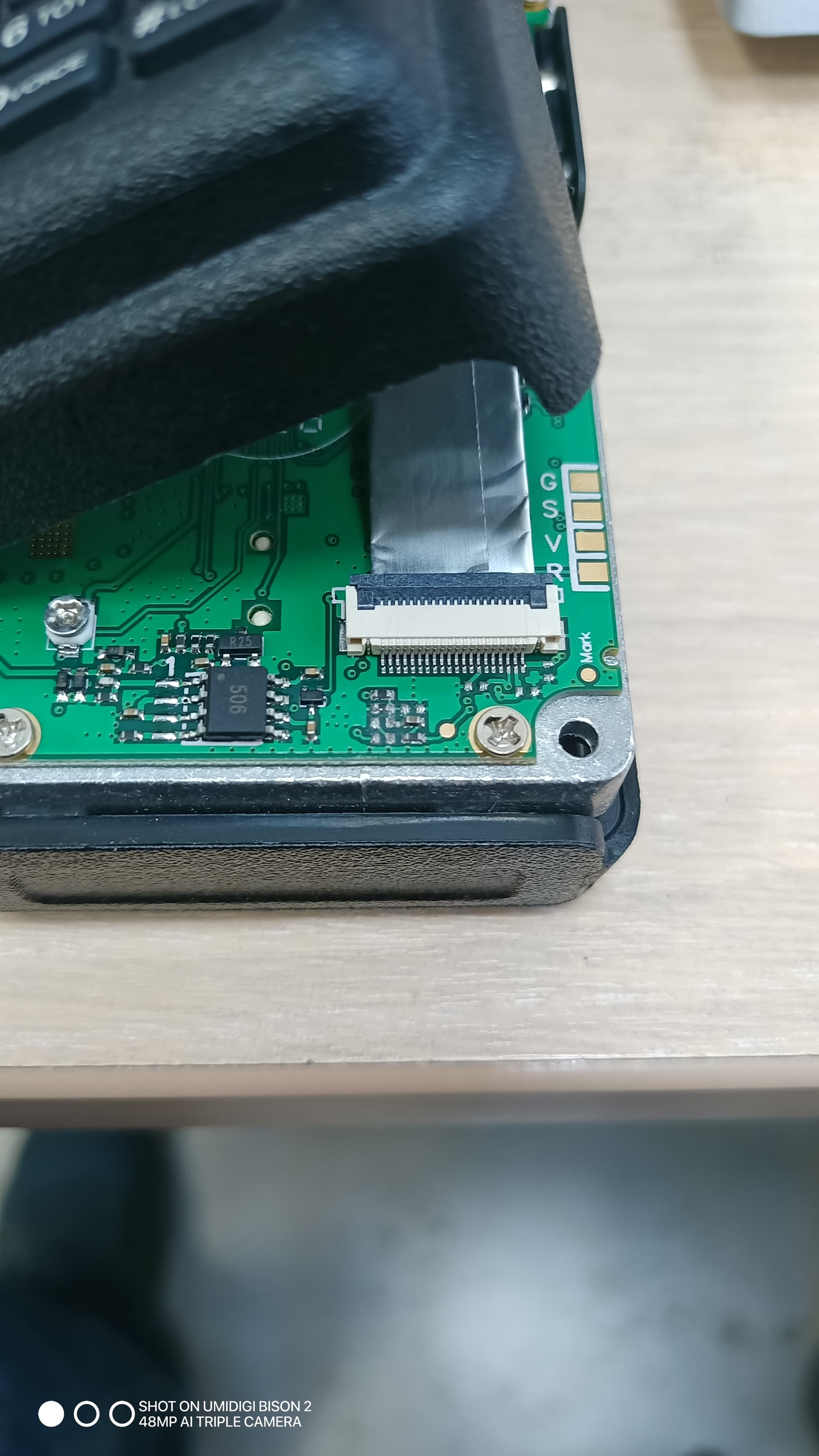

Hello my dear technicians
I have created a small problem with 2 components on the board.
The battery clips has broken and I damaged 2 components on the board when I opened the case. Abbree Store doesn’t help me. I need to know the value of those things to replace them. I have attached a few pictures showing the problem. Is someone willing to measure those things for me please? Thank you for your help and support.
