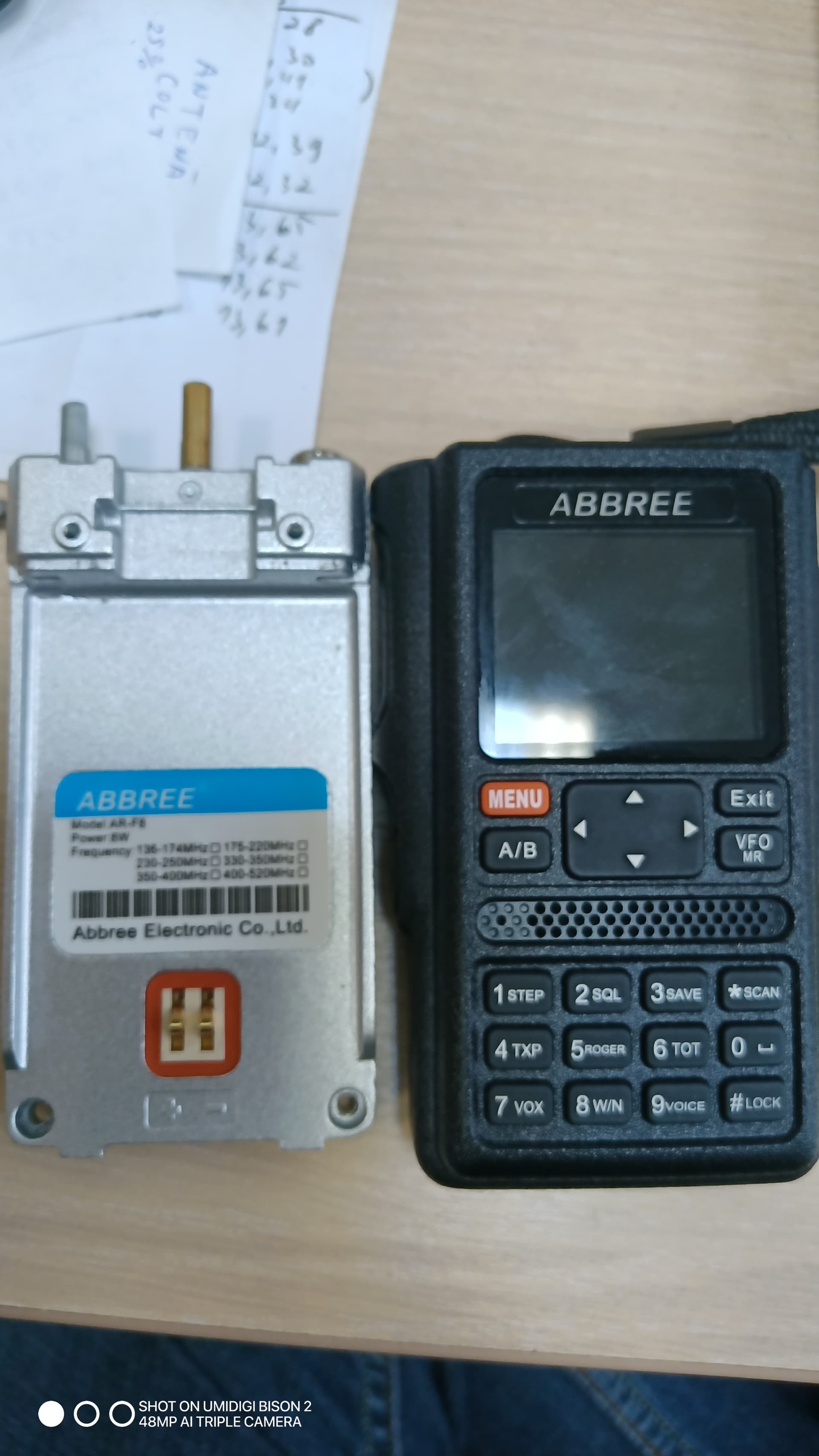

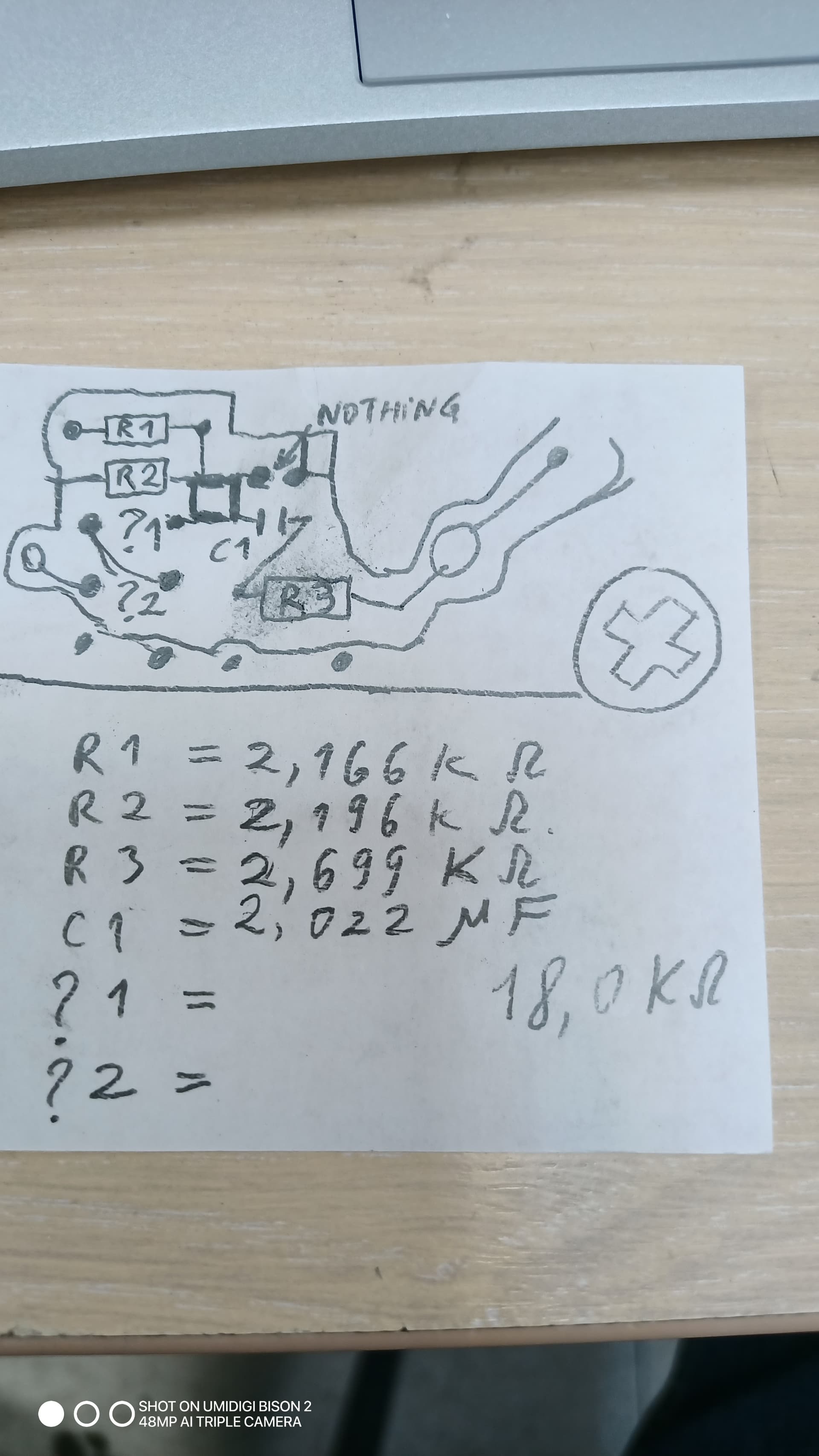

I tried to make a diagram. I would like to have your help with the value of the missing 2 things. Resistors or capacitor. Thank you very much.
You cannot do this without the schematic because the circuit compromises the readings a meter provides and with the circuit you can guess, but experimenting with swapping smd components will wreck the board after a couple of goes. Scrap it. Keep the battery. The cost of a proper solder station and the correct solder and flux for one repair is high. Two unknown components is what? 3 guesses for resistor or capacitor, assuming they’re not diodes. Then maybe guesses of high low or very high resistor values, same with capacitors. Without a circuit you can’t even be sure you won’t damage something else down/upstream. It’s Dirty Harry territory, how lucky are you?

Soldering the components is not the issue. I can solder 1x05. The Abbree doesn’t help with the right infos. Also they don’t sell parts, so I will have to carve the battery clip in aluminum. About the missing components I have 2 options: buy another radio or “ask a friend”. The radio is powering on, but I don’t know what is damaged. If I would have the value and types of those 2 things, I would be able to fix it. I have a Spectrum Analyzer to verify it after. I need the type and values for starting. I don’t have chance on Abbree store, so I am asking on a HAM group, probably I will be lucky to fix the radio. I found a piece of one resistor of ~18 kohm. But I noticed that another one is missing too. There is another empty space, with a clean solder, without component. So without a diagram I am asking (shouting out) for a hero with the right answer. So, is there a chance that you could measure those 2 things on your radio.

I cannot promise, but there is a chance there is one on the shelf in the store. If so, I will have a look inside for you and report back. Seriously though, does the radio actually work properly with those components missing? I wonder what they actually do?
I’m really sorry - I can’t locate the one I thought I had, sorry I cannot help.
