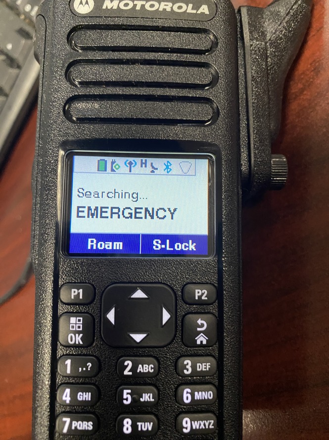

I just purchased a new XPR 7550E using 2.0 CPS. When I boot up the radio, it goes into this EMERGENCY mode/channel (see attached). Keypad is locked as well as the side buttons. I have tried the ORANGE emergency button but it has no effect. I have tried to turn it off using the CPS and haven’t found the right settings. Would anyone have any suggestions?
Yes, it was configured, somewhere, to go into this mode immediately upon boot-up. After doing further research, I found that I had an old version of firmware on the radio. I went to “My View” account in Motorola Solutions and loaded the newer firmware to Recover the radio. I should be OK now.
