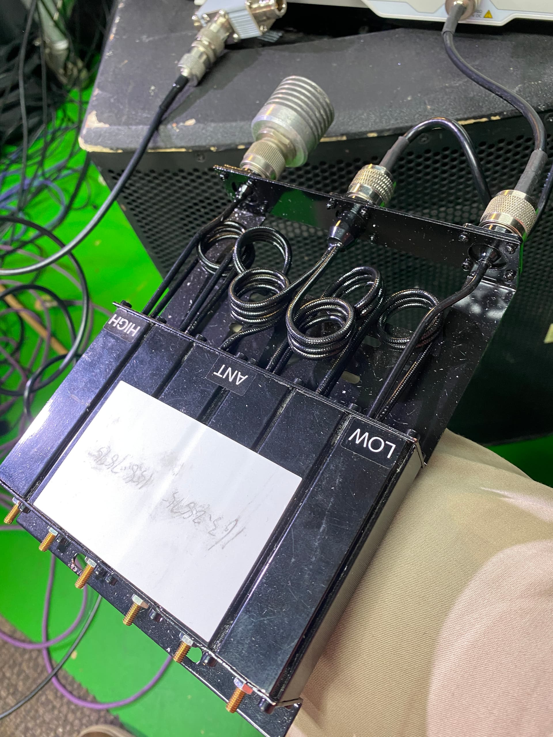

You mention a duplexer, so I don’t know what sort it is, but is it a cavity filter. A black thing about six to ten inches square with a port for an antenna in the middle and an in and out either side?
I maybe have misunderstood here, but if this is correct, remember tuning them is a mix of science and art. Even if you have a spectrum analyser with a tracking generator, tuning these things is a delicate operation, and until you’ve done a few, a longwinded and frustrating process. Tiny tweaks of the tuner suddenly produce the notch where it’s needed, but tightening the lock nut, you slip and knock it out of tune again.

Yes, to both questions. 5MHz apart and an XLT tuned to GMRS duplexer (Low, Antenna, High ports). I have the RPT Mode turned on both, one to RX (462.xxx) and the other to TX (467.xxx) w/ the extension cable ran between.

So the filters were tuned for you to those specific channels? The usual outstations transmitting 5MHz higher. The repeater listens on 467 and transmits on 462. The mobiles and handhelds listen on 462 and transmit on 467.
You say you cannot transmit, or do you mean nothing comes out of the antenna? I’d seriously check that the filter was tuned to EXACTLY your channel - remember these filters are very narrow - so while one channel up or down might be usable, two or three won’t be. It’s very easy to get the radios also connected to the wrong port - and if you do, nothing gets out and nothing gets in.
IMG_5136 It’s a little out of focus. Yes, when I ordered this I did have the option to have it tuned to a specify freq. I chose RPT channel 19 462.650/467.650. But as you can see, it’s tuned to the GMRS freqs in general. Wait, so a repeater is opposite?

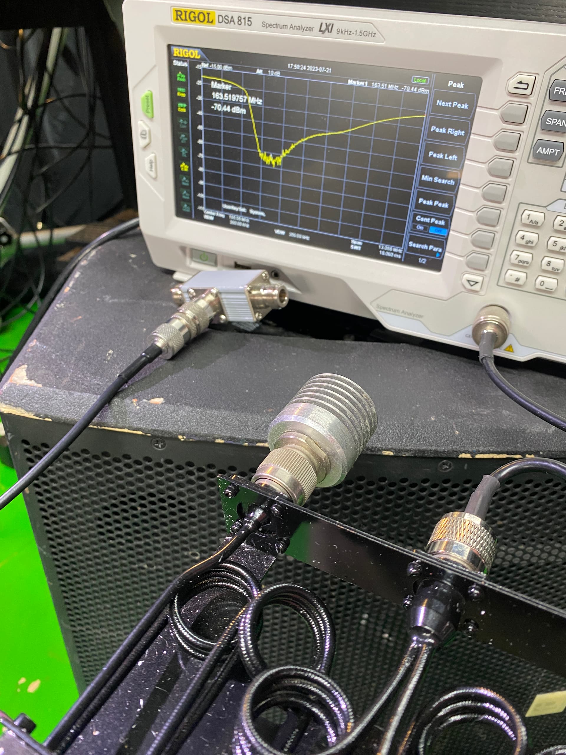

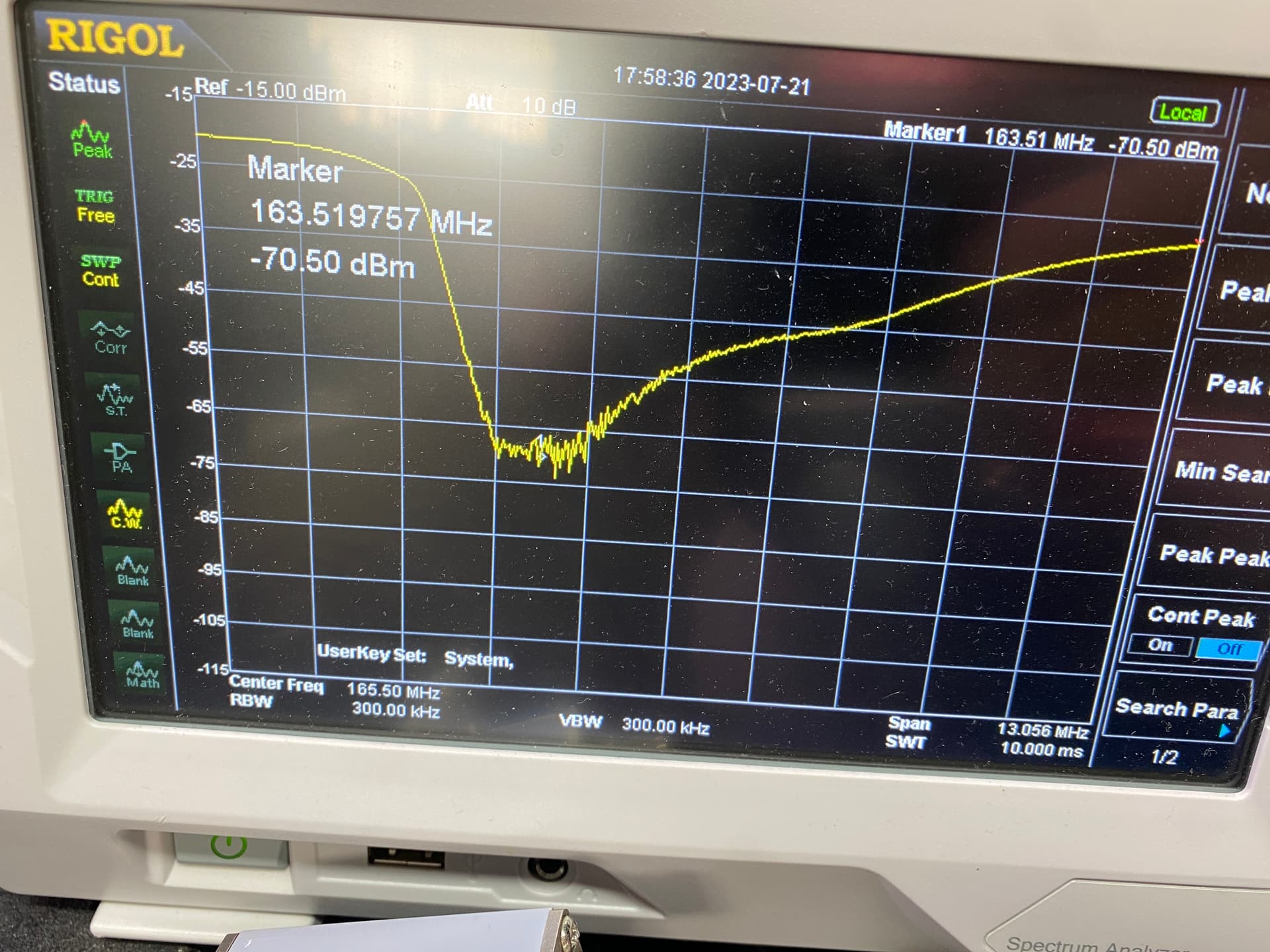

For fun, I took off the shelf a VHF one, and it has on it the two frequencies it is supposed to separate. I quickly connected the analyser and while it is close-ish, it’s not tuned properly. Much is simply it did a few thousand miles between there and here, and bumping is bad for the tuning. What I should see is a deep and ‘pointy’ notch, where frequencies either side are hardly attenuated. That filter is nearly 1MHz wide - so that jaggly low point should be a pointy solid line - it indicates that the three filters are all tuned to different frequencies. As a repeater filter it would give horrible performance. Watch a youtube video on tuning cavities for repeaters and see the level of tweaking needed to let frequency A through but stop everything else, and then the opposite on the other frequency. The filters are tuned one port high one port low - if you accidentally reversed it in the tuning, swap the labels. They are also quite finicky about impedances - so if you disconnect the dummy load you use when tuning one side, the notch moves. Same thing if the antenna is resonant on a different frequency - it’s impedance changes and so does your filter tuning. Usually only a tiny bit, but I had a J Pole antenna designed for a band 20 MHz away from the repeater - it worked poorly.
You cannot buy a filter, give them the two frequencies and then expect it to work - that’s not how this stuff works The label on yours cannot give a RX and TX spec as a range? One channel down or up might work, but two channels (as in 25KHz) is probably going to really reduce performance. You buy these things, then tune them locally. even 1 mile on the seat of my van was too much, and I had to retune on site.
