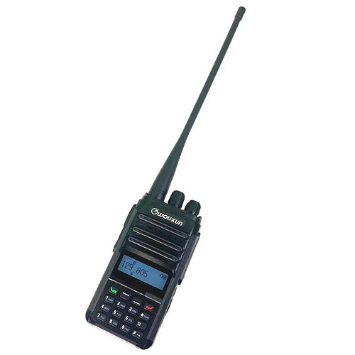

Wouxun released a few Airband transceivers last year. The one I have is the KG-R76 from the German OEM Wimo.
I’ve read that the same or similar radios have been released in other countries as well, under different model numbers.
The radio looks like this:
It has a USB-C port on the side.

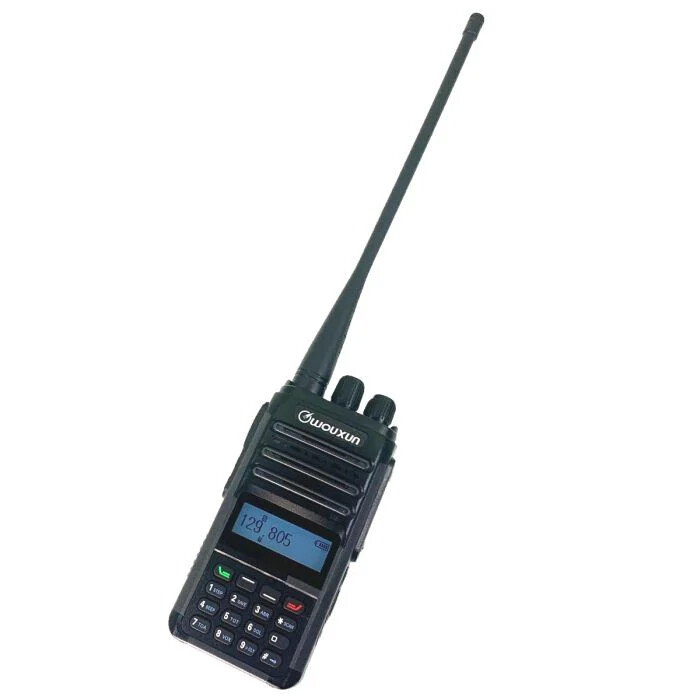

The KG-S74A is a similar / maybe the same(?) model:
There is also T76.
My question is, how do you program this radio? Also, the manual is really basic, most things are not included, I’m trying to read other Wouxun manuals to understand the explanation of things.
