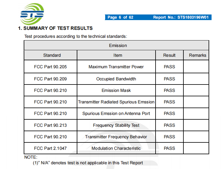

SAMCOM FPCN30A two way radios have passed FCC part 15 and part 90 rules, so can it be approved if it can be installed with a removable antenna?
Antenna Type: Whip Antenna.
FCC Part 90.210 Spurious Emssion on Antenna Port: PASS
