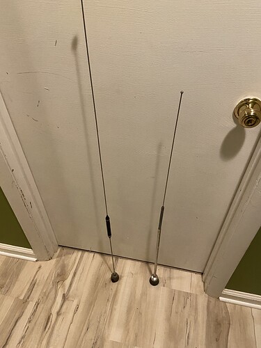

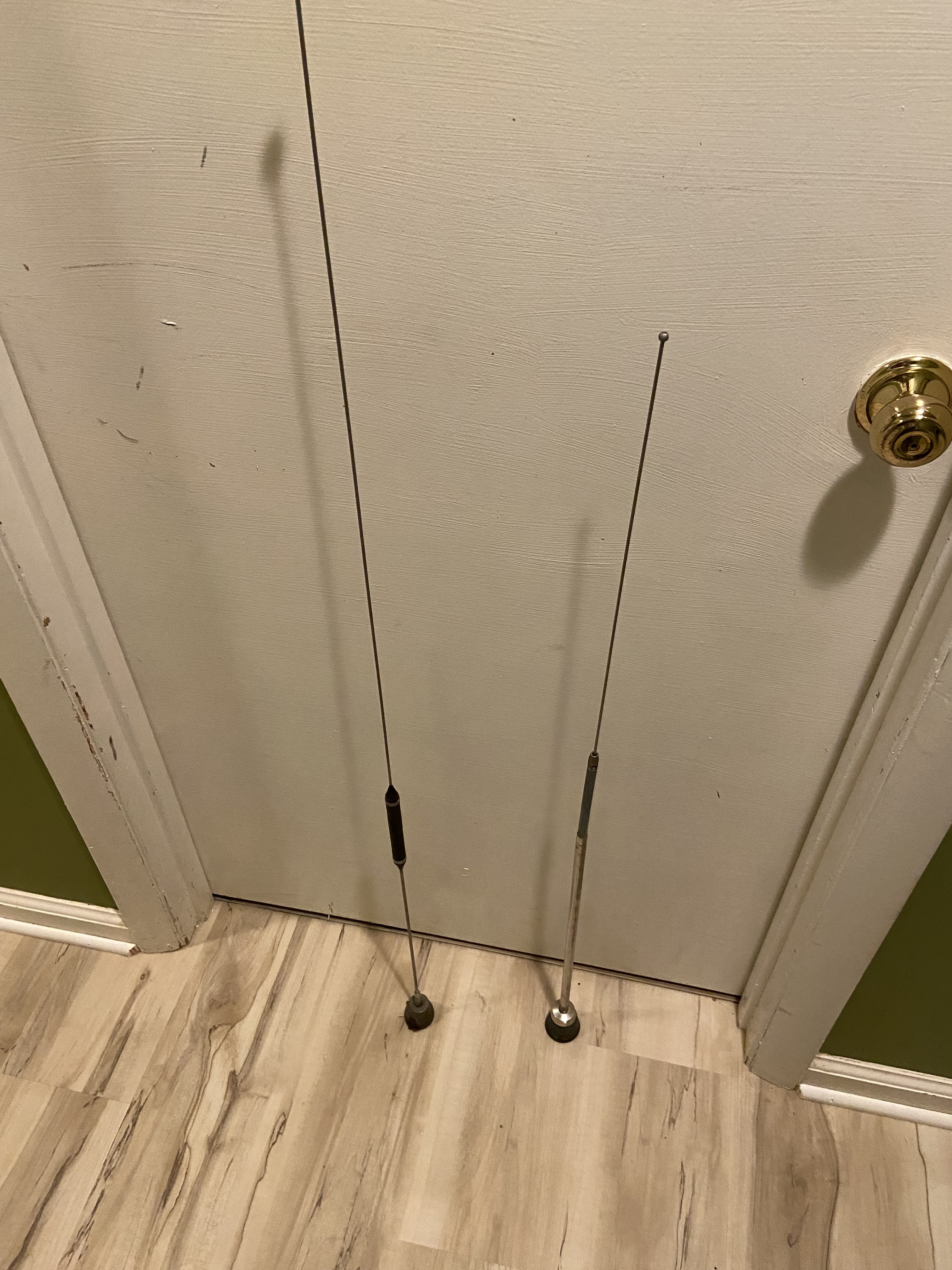

What antennas are these and what are they for?
Hey folks, I was wondering what I came across here at work. I am situated on a park by a large lake and we weren’t sure what these went to. Most likely they were either on a boat or a squad car, and they are missing bases.
I would like to use these on VHF or UHF if we can. I just don’t seem to be able to grasp what antenna is for what.
The only thing I’m sure of is they both have an NMO mount. My guess would be they are VHS because of the apparent length. But they could be dual band VHS/UHF antennas. Try to clean up the bases and see if you can find any printing on them either brand or maybe even frequency range numbers. If you have access to an swr meter you could hook them up to a radio and see what the swr is with what ever radio you are using. If you have a antenna analyzer that would be even better, it would allow you to know what the antennas are tuned for. You can try to figure out what the tuned frequency is by measuring the length and then figure out the wave length or fraction there of, although they both look like they may had some type of coil/load on them.

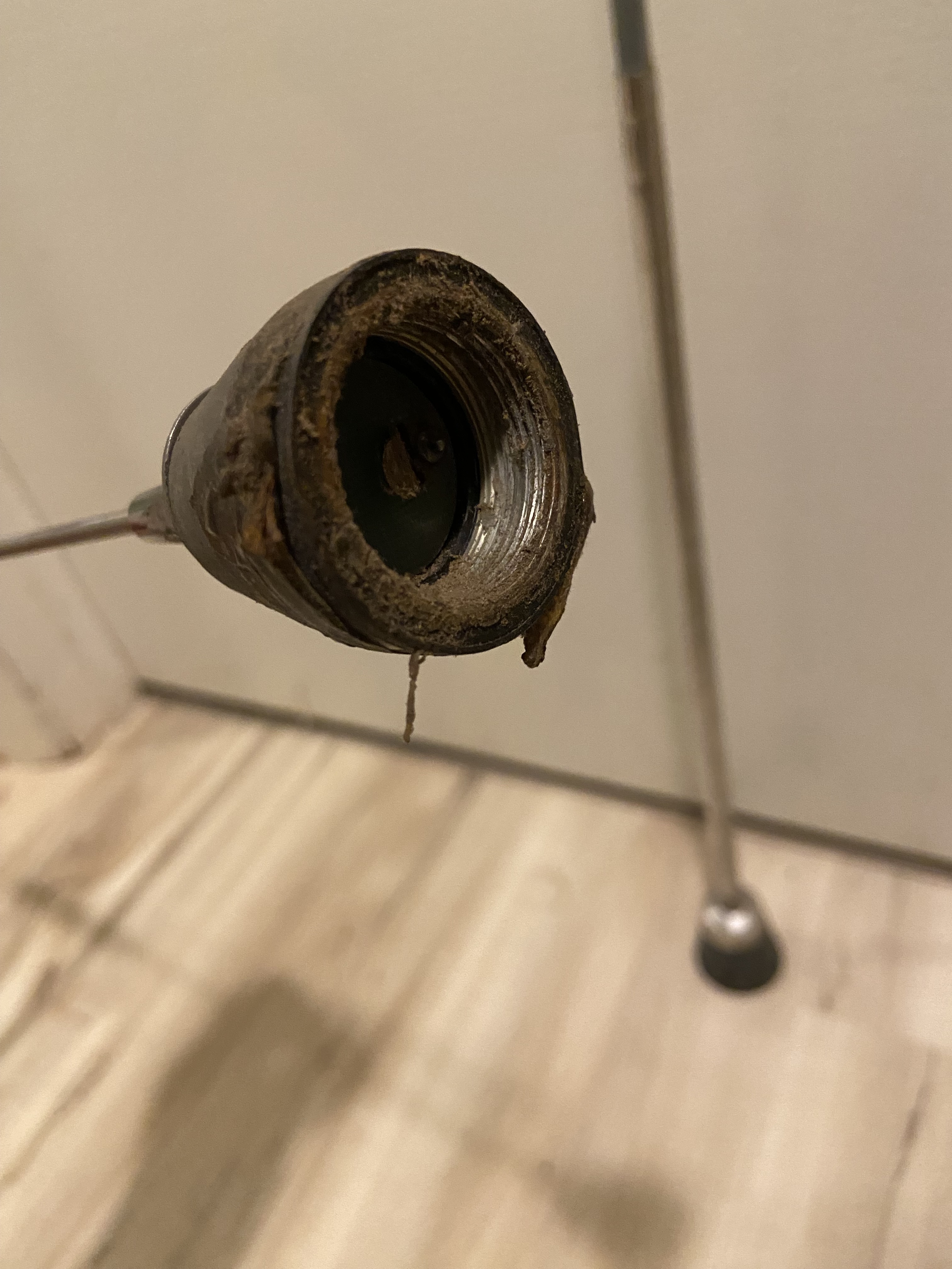

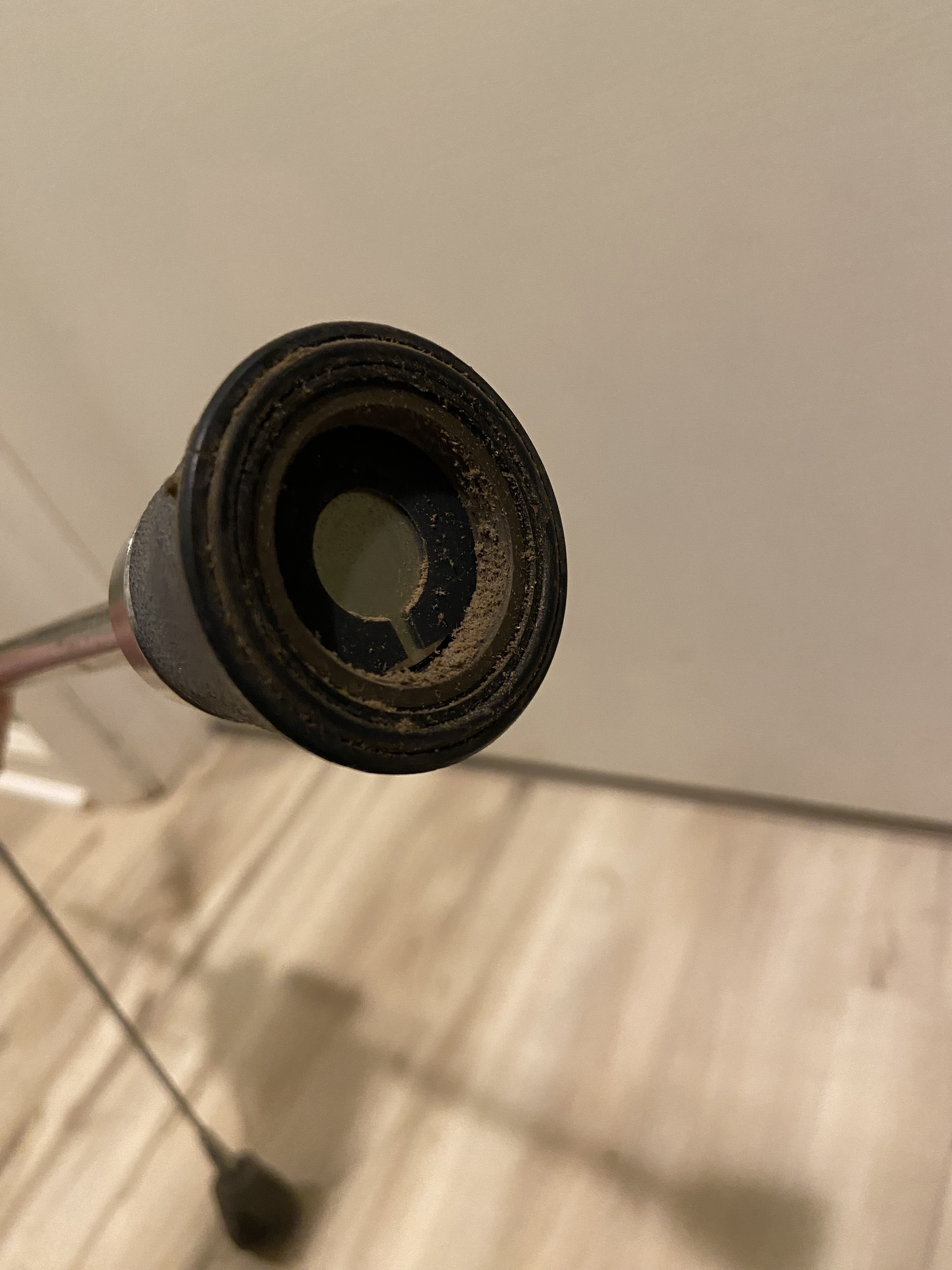

I’d have to agree with portions of both previous answers. The one with the load looks more like a two band than the other, but both appear to be VHF. As far as the NMO connectors either the spring probe is broken off or these are some reverse NMO. The won’t work with the standard NMO mount. Cleaning the corrosion from these beauties will be a real task. For my money I’d suggest taking them out to the middle of the lake and dropping them in.
Thank you. I need to clean these up and see if there are any markings though looking over them I didn’t see anything.

Well…the antenna on your left appear to be an NMO type antenna and you would need to buy an NMO fitting that has the coax attached to it for it to work. Also, it might be a UHF antenna or a Dual Band antenna. The antenna on your right, looks to be a UHF antenna as well. Hopefully the will be someone who would know for sure…
One of them should. The antenna that the author is holding is holding is DEFINATELY an NMO and will screw into the NMO base with no problem.
You’re correct there. Different antenna bases are made for different antenna’s and are NOT made to be interchangeable. Keep that bit of info in mind for future reference…
