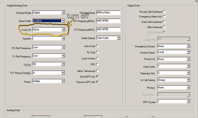

The radio was locking up when in DMR and worked ok analog found that scan pul down need to be turned off. My tyt 2017 worked ok with this on just not the 9600.
I was wrong in post it fixed radio temp. The radio was sold marked GPS and that firmware was the cause of problem. Flashed radio with non gps firmware and lockup problem is gone. I purchased a used radio on ebay with non GPS and it is working good too.
