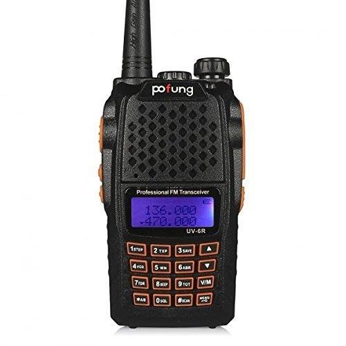

Those cheap Chinese-made amateur (HAM) radios are actually reasonably good quality for the price. The problem is that HAM radios are not intended for business use. I will wait for people more experienced with HAM radios to weigh in here, as I am not an expert in amateur (recreational) radio.
Technically, you can program some of those Chinese-made HAM radios to send and receive common frequencies such as MURS, FRS or GMRS but it is not legal to do so (except in an emergency.) While it might be tempting to give it a try, thinking the chances of getting caught are slim, consider there are lots of regulatory agencies listening, and they may not be so concerned about a couple of kids using common frequencies for their airsoft toy games, but they will be very concerned about heavy business use from a film set. Fines are quite steep.
And, let’s not forget Sarah Jones, and what happens when filmmakers break the law and try to “sneak around.” I was being very serious about professionals using professional equipment.
Plus, if you program them for FRS, MURS or GMRS channels illegally, you are still going to have to contend with every kid and every drive-through in a five mile radius interfering with your communication.
