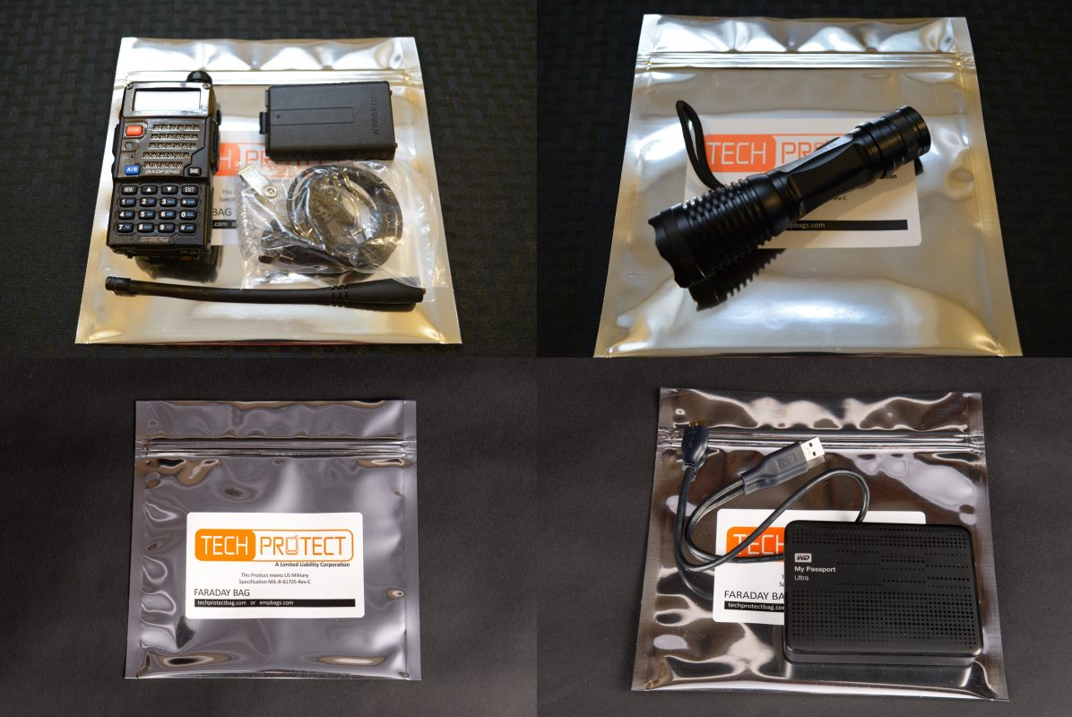

I have gathered quite a bit of GMRS gadgets, Testing tools, accessories, extra batteries, and the like. I bought the Wouzon HT carrying case, love it. But I am always thinking multifunction. As well keeping everything together has become priority No 1. and yes 1 in 1000 chance of EMP burst in the next 30 to 50 years. (guess I have too much covid/winter cabin fever). Protect your investment? Or just food for thought.

Call me a gloom and doomer if you wish; ā€œprepperā€ would be the preferred term. After attending a security threat analysis workshop hosted by DC analysts, and because NoKo has proven the ability to reach space and has nukes, with others there or not far behind, I have radios in faraday cages. I bought two pair of Baofeng UV5Rs for this. I use metal cookie-tins that once held holiday treats (sanded down to bare metal at the rim and inside the lids for good metal-to-metal contact. Inside, are my ā€œgadgetsā€, wrapped in small bubble wrap, wrapped in aluminum foil, rinse and repeat several times for several layers (none with conductive contact to the other, then placed inside the tins (with more wrapping to ensure it cannot touch the sides) and sealed with metal tape. Make sure the tape has conductive adhesive, can take some googling. I then test each ā€œcageā€ with a multimeter to ensure there’s a short circuit between the container and the lid. I have several of these, some in cookie tins, some in small alum. trash-cans. In addition to cheap radios bought for the purpose, I’ve added stuff from junk drawers around the house: calculators, flashlights, an old ipod, an old kindle, a tablet, spare zip drives (one with important docs loaded) etc. Wasn’t using them anyway, or had plenty around. Call me whatever you wish, I think it makes sense.

Keep my handhelds in an unused microwave which is a type of Faraday cage as microwaves cannot escape.
