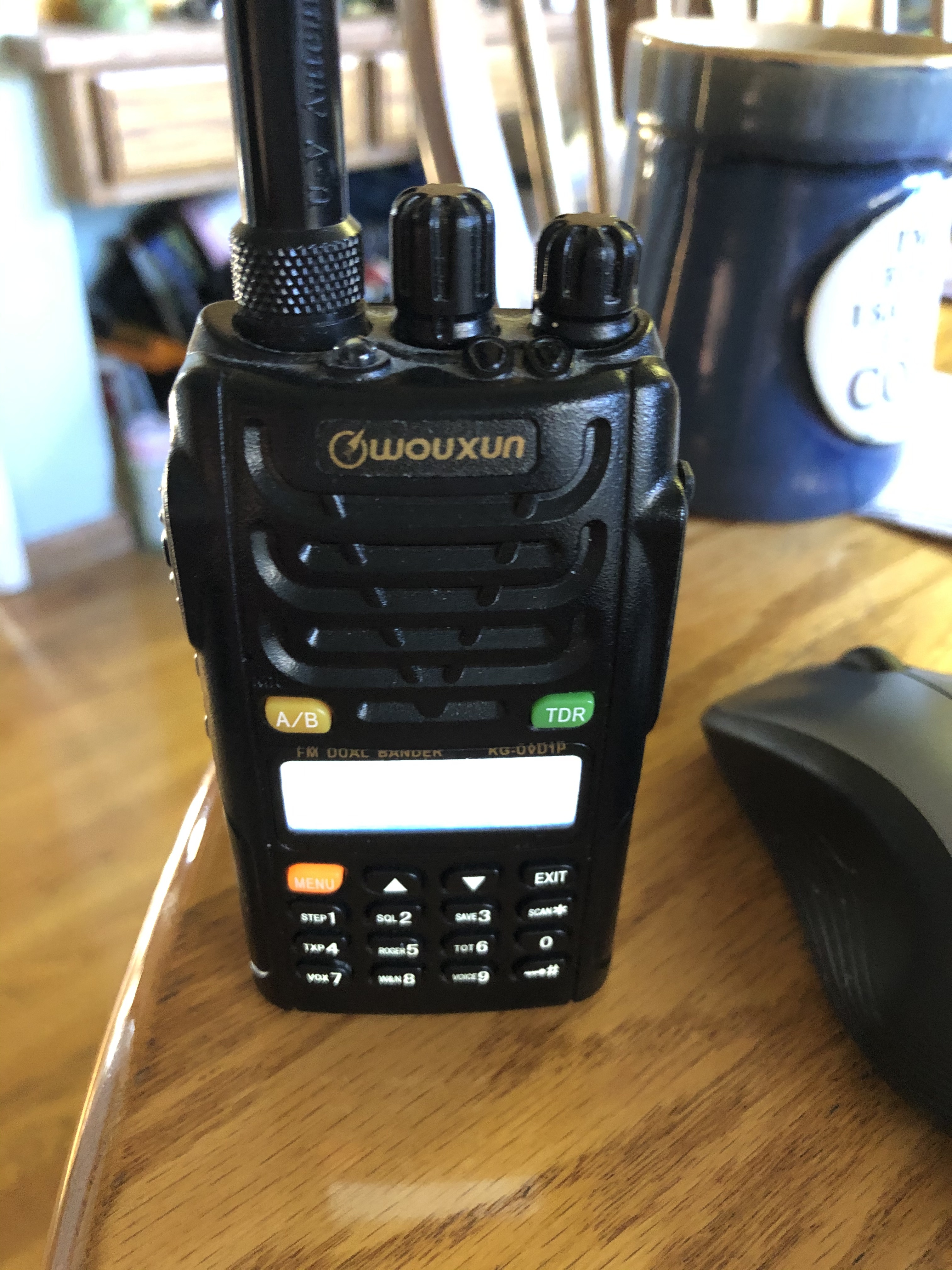

I inherited one of these from my late father. I believe he purchased it in 2013. The battery was not accepting a charge in 2019, so I purchased a replacement battery. The unit sprung to life and seems fully functional with one exception. The LCD panel lights up but with near zero contrast, so lettering is too faint to read. I’m not seeing a contrast control in the manual. Does anyone know how to adjust contrast/brightness on this model?

The LCD is lit up so back light is bright. I’ve attached a picture. It was working a couple years ago. It was stored indoors and not in any sunlight and kept in the charging cradle plugged in since 2016. I got around to trying it a week ago and discovered the battery was toast, so replaced that with a new one. Radio is completely functional and talkative otherwise. I get good reception on some channels.

Okay, sorry, I misunderstood. I thought the backlight was weak, but it’s the LCD itself that is barely visible. I don’t think a reset will fix that, but it’s usually a first step in troubleshooting. There may not be sufficient power going to the display chip, which could be caused by a poor connection to the board or a failing component on the board for the display driver. Without putting it on a bench and opening it up, it could be several things, but based on the image and what you told me, I’m leaning towards the latter.
