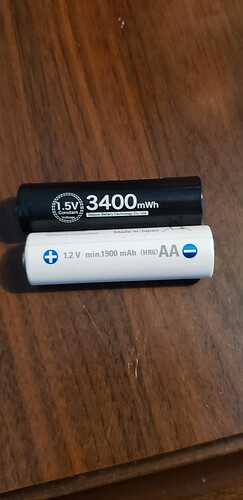

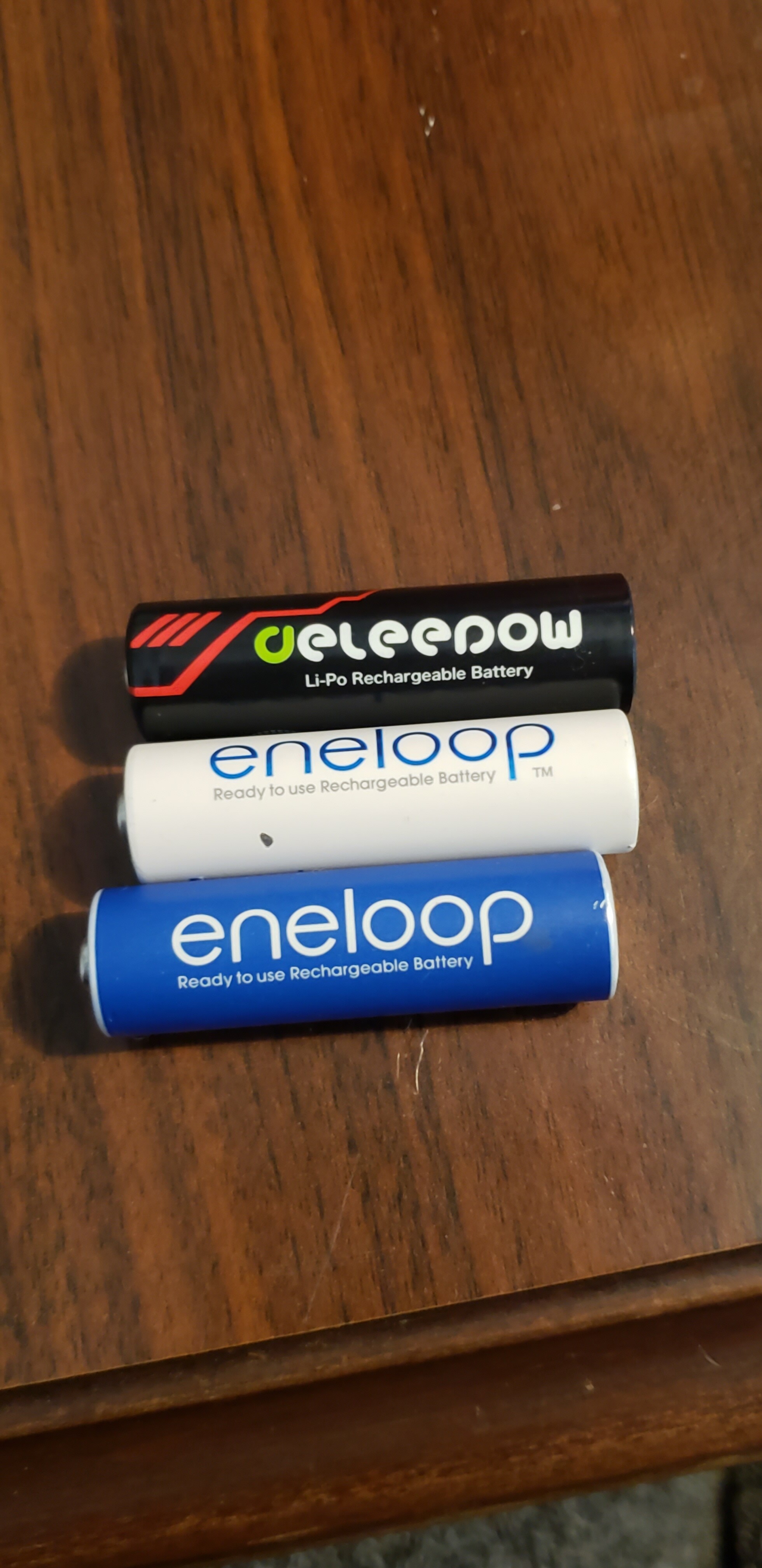

In photo you see two version of the eneloop’s and the new Li-po rechargeable. The eneloops have poor lasting power. moreover, they are not enough voltage. The new LI-po AA and AAA rechargeable all have high mWh ratings.

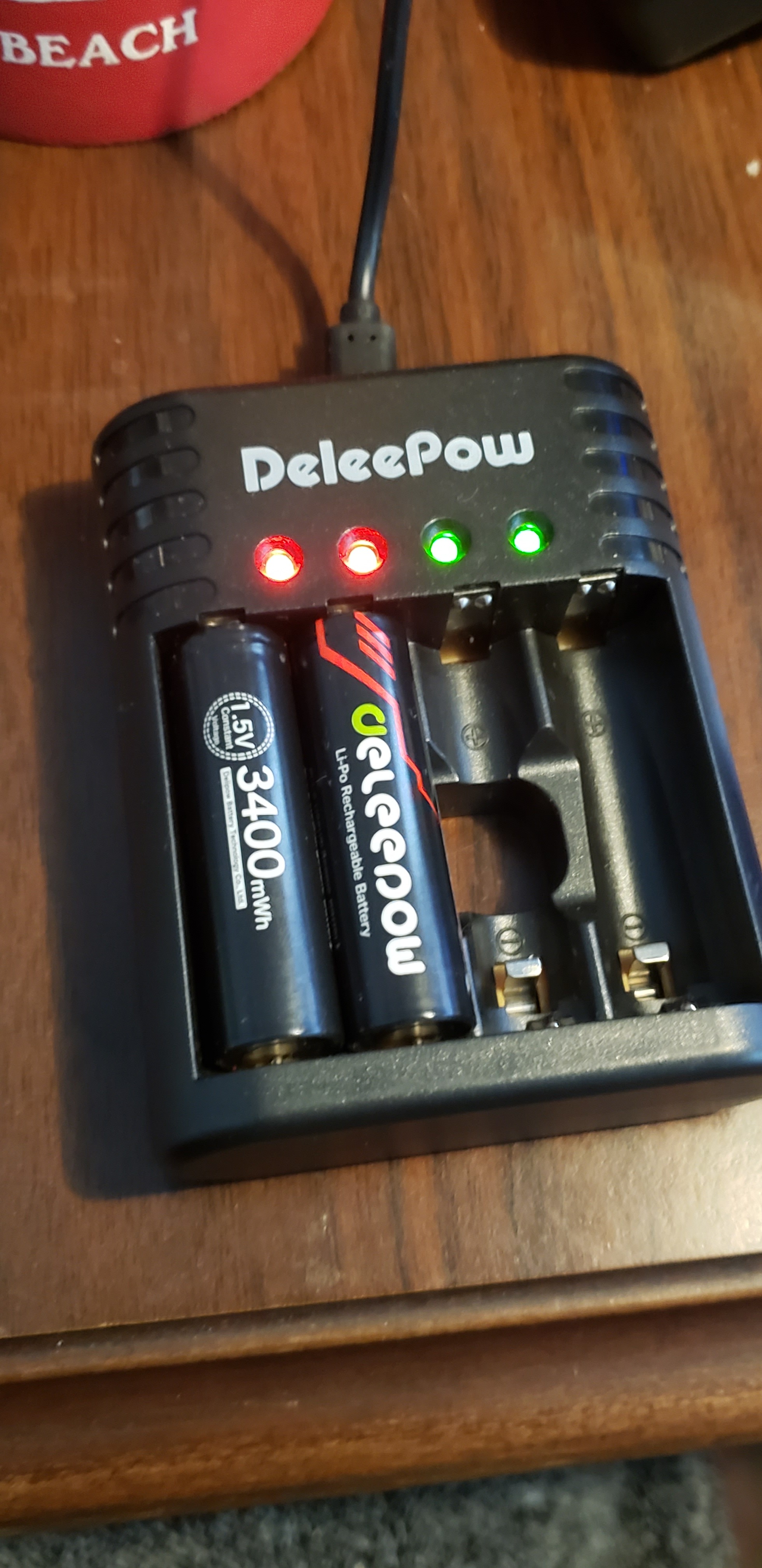

I have a set of MidlandGTX1000 and a KG935G with a extra battery pack using the Li-po’s I am very happy and is worth the extra cost. The Li-po are not in the major markets yet. They are designed for a special charger. so fully charged then in the stock radio charger port is not recommended. But I have tried it and it works. The deleePow are amazing. they power drain is concsten till the very end, then bang there dead and need recharging.
