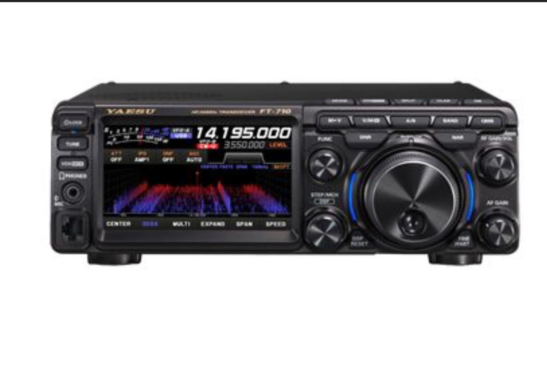

I believe this is the radio you’re referring to:
