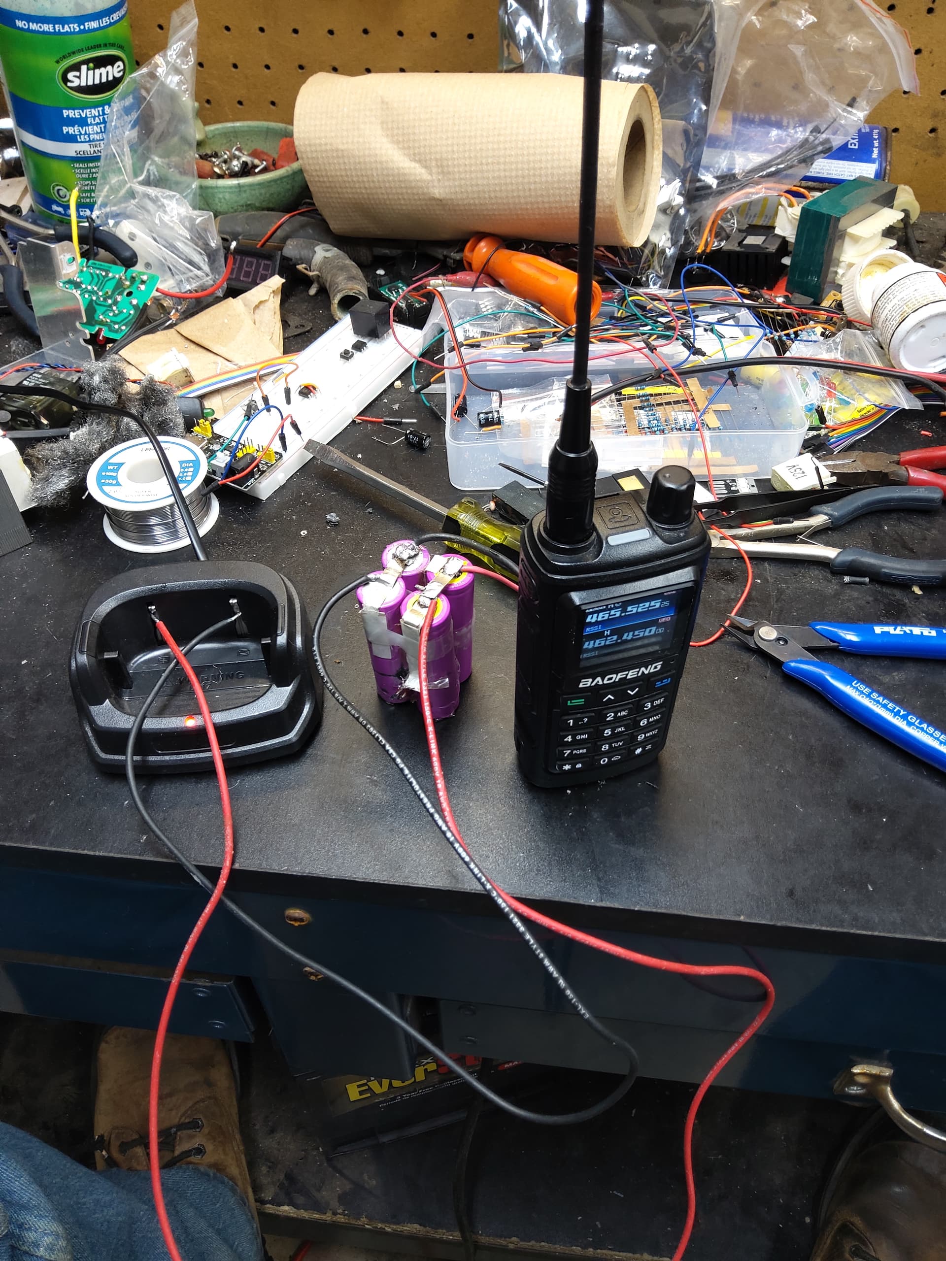

I think im going to use 2 18650’s in series for 7.4V.
It looks like thats what the TIDRADIO H-3 is using.
All of the handhelds I own (none are Boafeng) are spec’d at 7.4V. The on-board voltage meter shows around 8.2-8.4 volts fully charged and around 7.2 volts at 15% (lowest I have gone). I do not know what the amps draw is but that will change depending on what frequency and and power setting you are using.

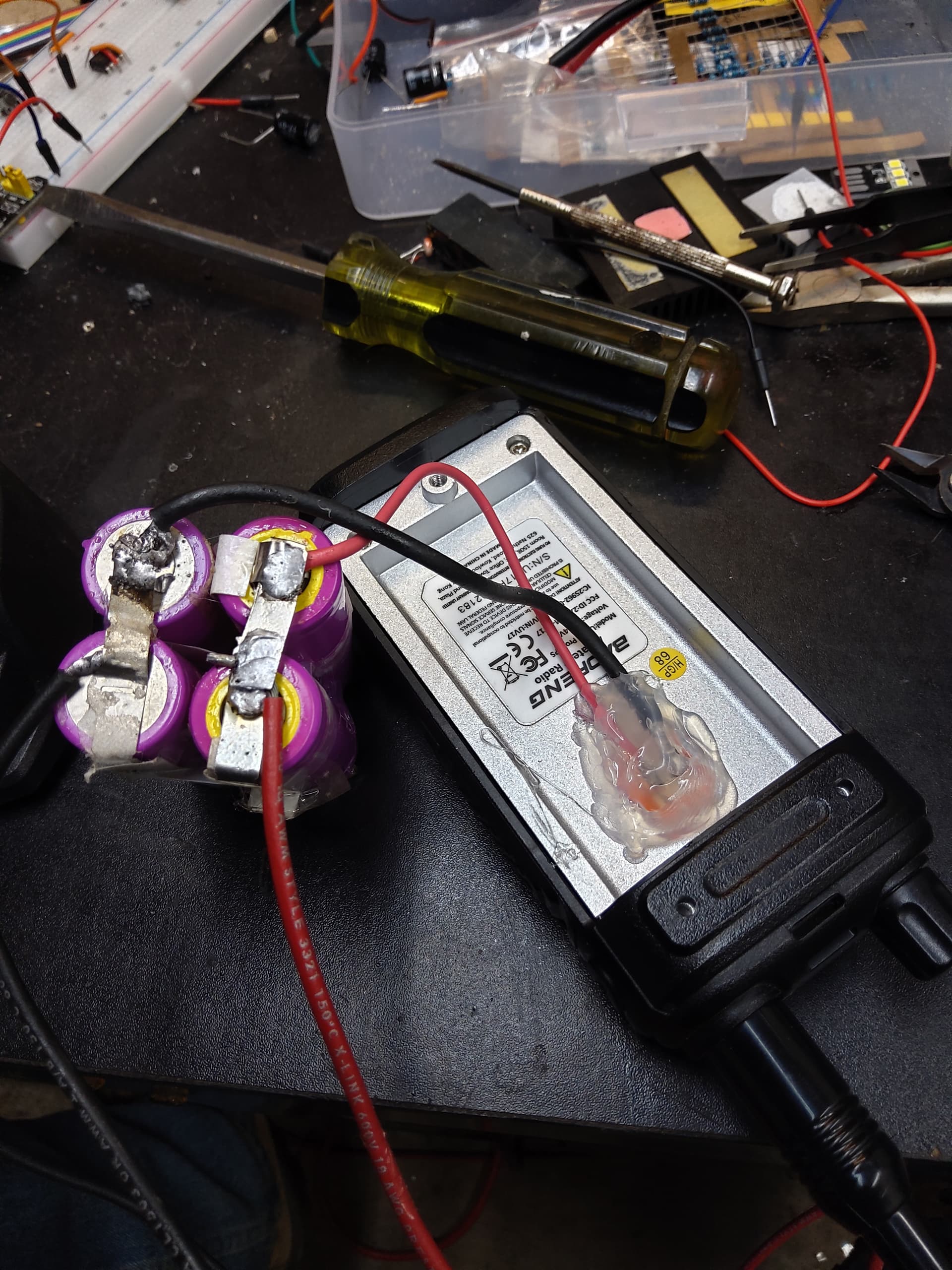

Got the 4 of them charged and balanced them to put them together. I’ll need to get 8 more of them for the 2nd. Then both will have 6.
36 hours plus into testing the battery and it is still showing about 50% and 7.1V. Going to try and make a solar charge controller next with some old 7V solar panels from the dollar store…

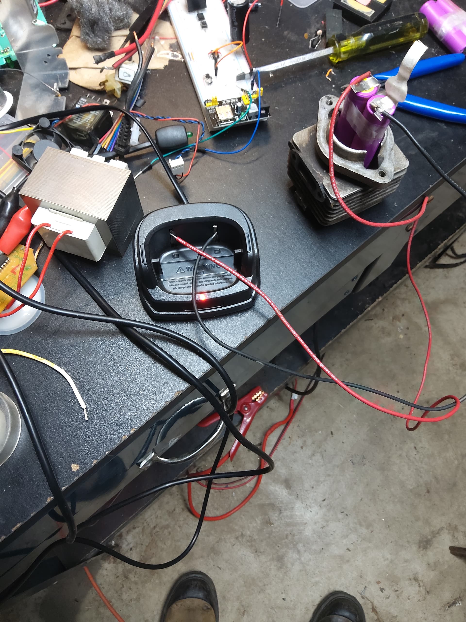

Nobody’s going to want to steal this…lol
This might have been a little neater way to go.

What is the terminal voltage of that charger when charging. My guess is the load drops it down below what the new batteries need to charge. Check the current too.
This radio is going to be placed in a shelter. Im just using some scrap material to make it with.
I have to make it so that nobody will want to take it.
Cant make it look like they can sell it.
The current is low from the base charger. Under 1 amp. Voltage is around the 8.4V mark.
I was able to hook up a meter to the charger and the batteries took about 3400 mAh of juice.
