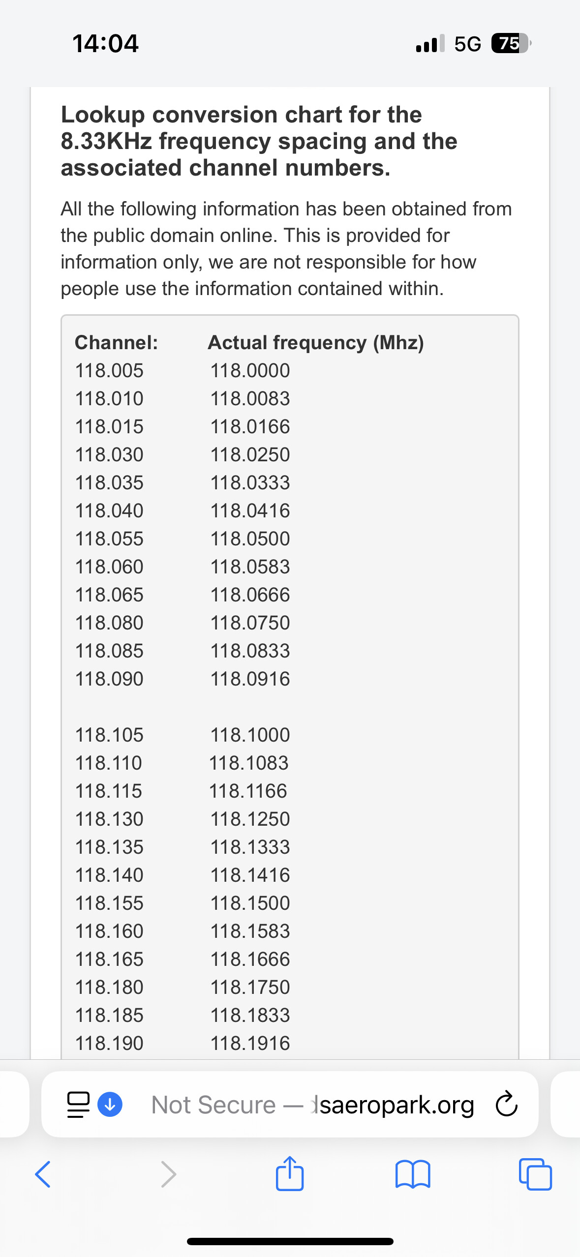

Hi Paull, did you find a way arround the 8.33kHz channel spacing issue ? glad i found your post because i was about to purchase the radio as a backup unit here in NL.
No - the manufacturer has NOT fitted 8.33KHz channelisation and doesn’t seem to understand the need - although it may be a language problem - and Google translate. 6.25KHz is actually close enough for it not to be an issue - but no good for pilots who are already confused as to why what they tap into the radios is not actually the real frequency.

It is like someone did not understand the difference between channel and freqency.
So many pilots in training struggle with the comms module. The old system was logical, the new one far less so. Even worse for hobbies listeners who have to put in the frequency, or at least as close as they can get. So there is a frequency spoken or printed that is actually something else is reality and then you have to convert that to your receivers spacing! Thankfully the filtering in most radios we use is wide enough not to matter. In fact it only seems to make a difference when two side by side frequencies are both in use, and for me where I live, that rarely happens.
