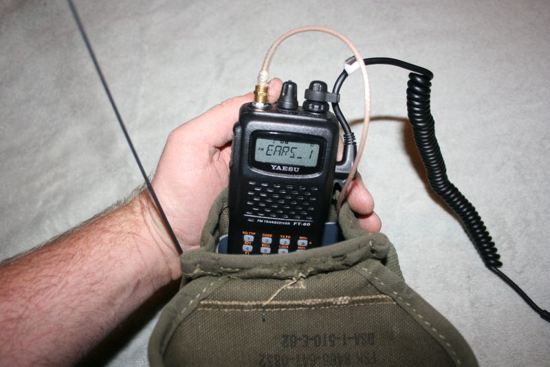

This solves the problem?
The name in the display is just a crazy coincidence, but neat!
It would solve the problem, but a better place for that retaining clip would be on the antenna, not the frequency selection knob. A pull on the mic cord could accidentally change the frequency or memory channel. Unless, of course, you use the keypad lock settings to lock that knob as well.
