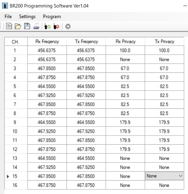

Hello All,
Can a Kenwood two way radio be programmed to frequency 456.6375 in order to work with some Midland business class radios? Can the Kenwood also be programmed with the same privacy codes, otherwise must those be set to “none”. As exampled in my Midland programming software below. Channel 1 is set to 456.6375 with a privacy code of 100. Whereas Channel 2 is set to 456.6375 with no privacy code.
