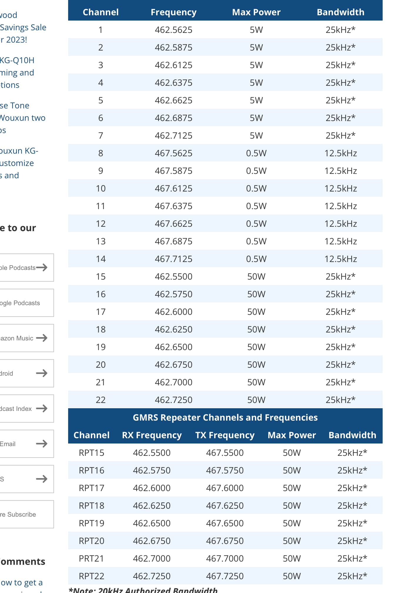

Streaksf7, First, Welcome aboard👍 Some great people here, always willing to help. Now for your GMRS issue. You mentioned wanting to add a GMRS frequency to an existing radio you have, apparently. That is NOT something I would recommend❗️
Here is a list of the GMRS frequencies complements of “buytwowayradios.com
Honestly, if you’re trying to get into the GMRS radio hobby, purchasing a radio designed for and approved by the FCC is a far better option.
buytwowayradios.com has a helpful staff that can assist you in making the best choice.
(888) 569-9499
Best wishes :+1:
