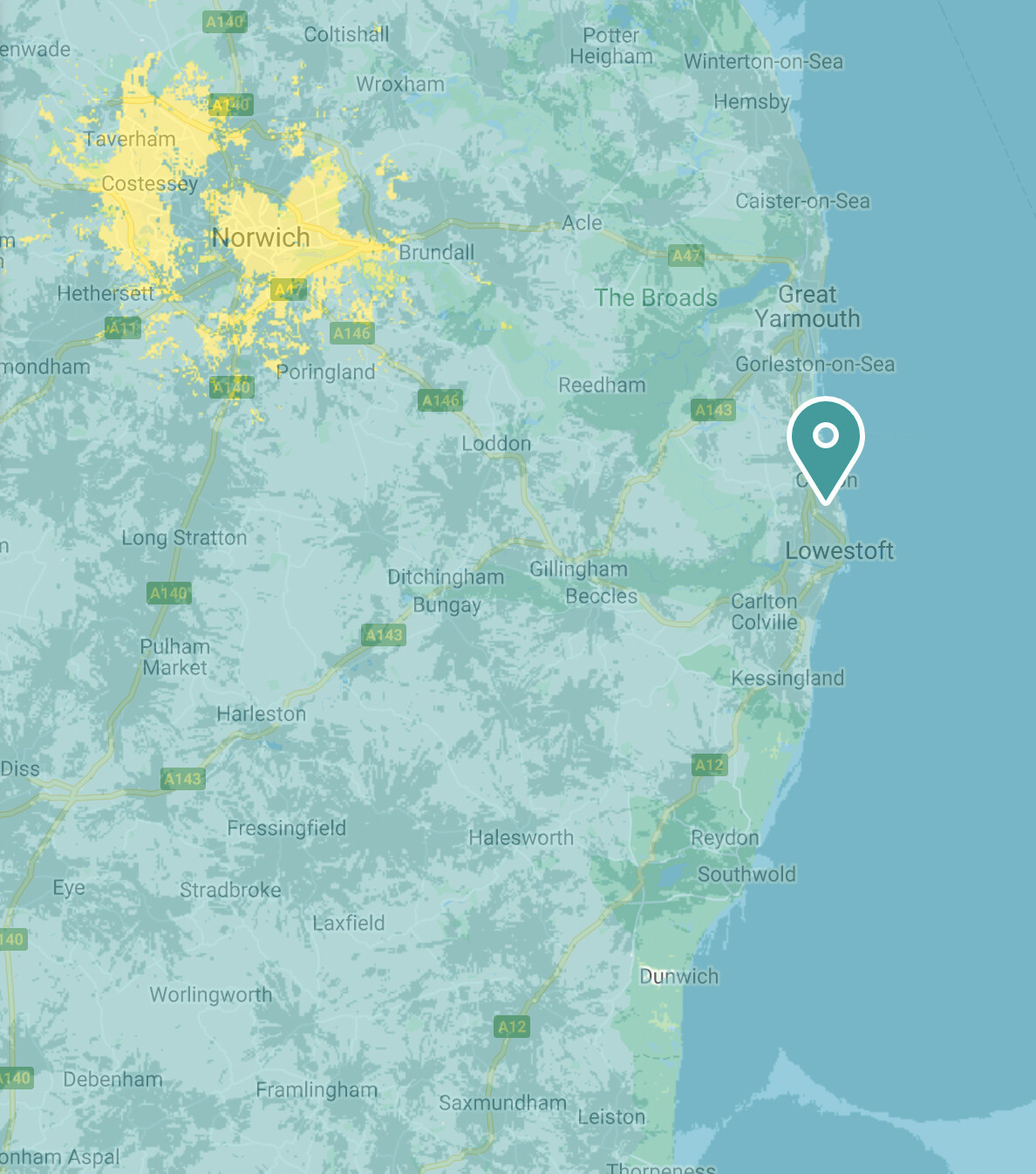

5G doing well in the big cities - but rural areas can be 2G! Yellow is 5G, then 4G the darkest, 3G the mid green and the light green is 2G. An inconvenience for the public but impossible for the emergency services.
Thanks for the update. We have no 2G. 3G equipment is rapidly being removed from cell site huts to make room for 5G equipment. All the carriers are racing to be “first” with the most 5G coverage here in the United States. 4G, LTE (Long Term Evolution) is the current norm, here.
5G millimeter wave antennas are also being rapidly installed on utility & street light poles that provide gig speed but for very short distances. As a result, the antennas and equipment must be installed on about every 4th pole. That arrangement can be unsightly, from my observations.
Is there any 5G mm wave technology being installed there?
I understand we have the same street lighting plan as you for 5G, but certainly 5G will be a long time coming here where I live I think.
