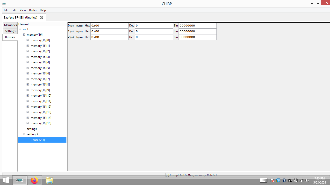

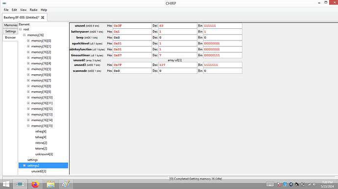

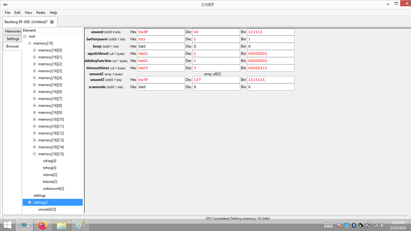

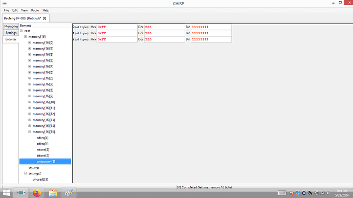

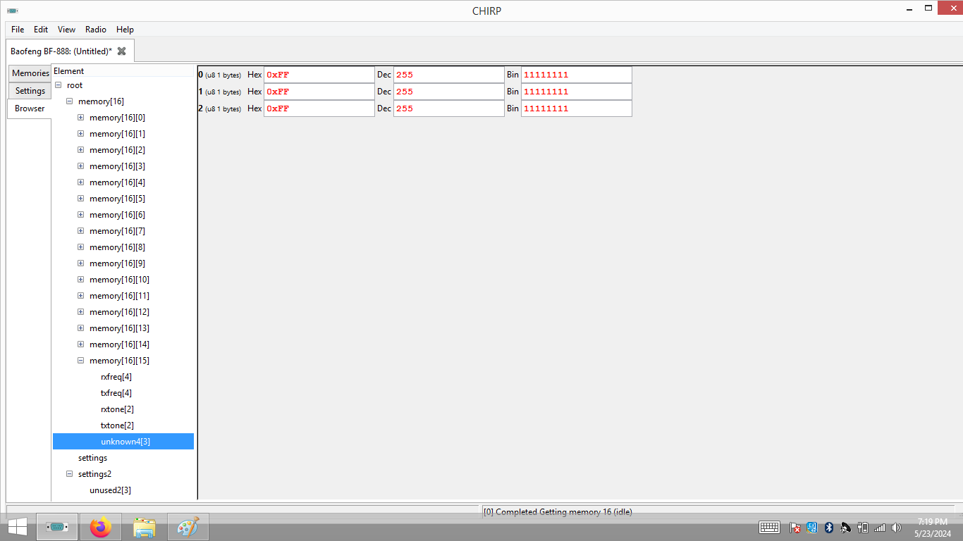

in the pictures the ones that say unused and unknown is probably where something got changed hope someone can help me out :frowning:

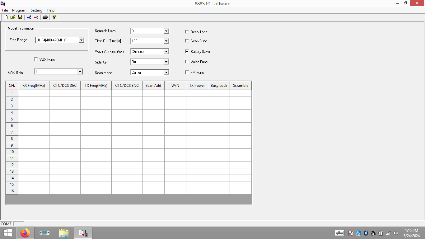

where would that be located it has that on the other program let me take a picture and show you
you see where it say freq range but as far as finding that in chirp i dont know
i think the program i just showed you changed some options you cant see is the reason there not working idk probaly wont get them fix will be my luck hopefullly you can help me figure out something thanks by the way didnt think anyone was gonna reply

Its not very clear the current status and what exactly you did. The screens dont explain the before and after, and you cannot tell ‘correctness’ from hex codes.
i used the bf-888 program to program the radios i just been reading some stuff the model of my radio is a bf-88a so the program is what bricked my radio i was supposed to use chirp with the bf-v8a option from what i been finding out online have to buy another one just like it and get the files that way i guess
