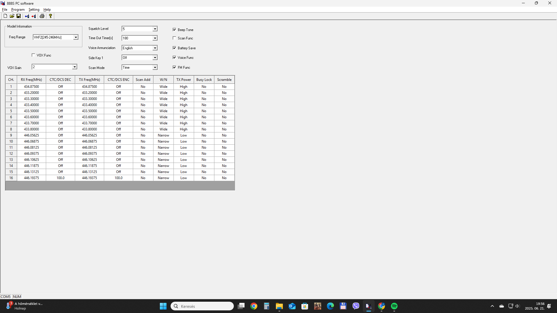

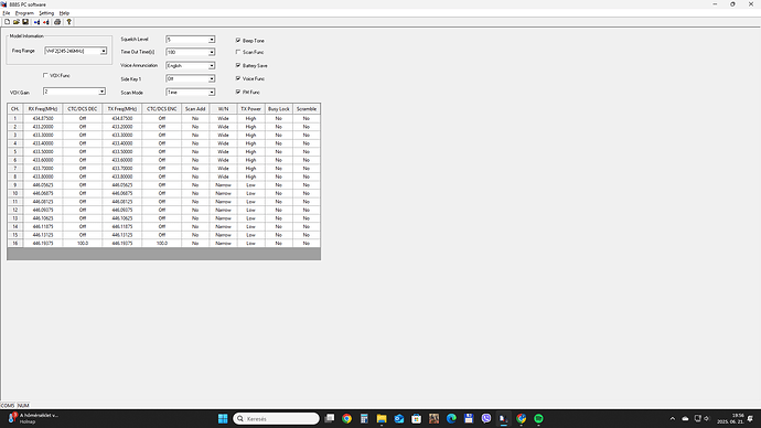

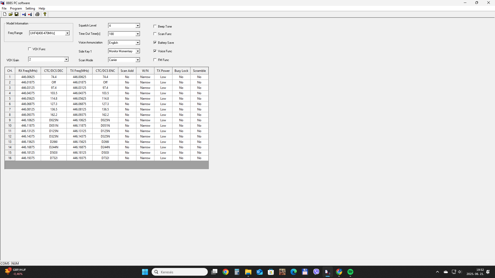

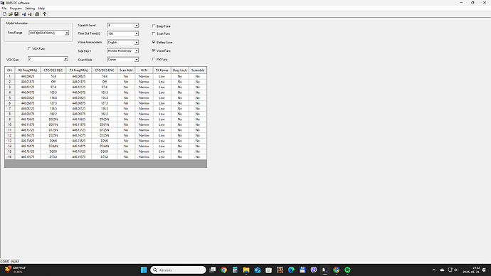

First of all, thank you for your response. So I can read and write the radio programme. I use MIKLOR 1.5. My problem is that I set the frequency band to 400-470, I set the PMR 446 frequencies and when I upload the program to the radios, on the channels where I have set the encoding the remote station just buzzes when transmitting, and where I have not set the encoding there is no reaction. I found a program that someone made for himself and half of it contains PMR446 frequencies. I uploaded it and miracle of miracles it works, but what I don’t understand is how they could program PMR 446 frequencies with the frequency band set to VHF2 (245-246Mhz) in the program. By the way, I have seen such a trick with the factory setting. To illustrate, I upload my own (not working) program called Baofeng recovery PMR 3 and the one that works (Baofeng recovery 2019) , but it contains eight frequencies that are not free/legal in our country. Do you have any tips on how I can make a working program or what I might have done wrong.
Sorry I coud not upload the .480 extention files so I uploaded one sreen print, the not working one.

The band 2 frequencies shouldn’t accept 440MHz - So you have two codeplugs - one has PMR446 only with 16chs and various signalling and the other has 70cm ham frequencies and PMR446. Only one works? Can you not get the working one and just enter the frequencies you want? I think I must be missing something. Nothing wrong with the contents of either, within the radio’s spec - but the Band 2 version isn’t normally imported to the UK as we do not have that band. No errors I can see with the parameters entered - just the band thing.

So, I can read the radio and I can upload a program to it. So far so good. However, if I write a new program to it, even though there is supposed to be no error in the program, I can’t use the radio as intended, because if I press the transmit button on one of them, the other one just buzzes and I can’t get the sound to pass. This happens when I encrypt the channel. If I don’t encrypt it, it doesn’t work anyway, it just doesn’t even buzz.
The odd thing is that both the factory program and the one I downloaded from elsewhere have the frequency band set to 245-246Mhz, but the individual frequencies I have specified do not fall into this band. Now this is not worth it. And when I try to enter a frequency within the running program, it only allows me to enter the specified frequencies 245-246Mhz. If I change the frequency band to 400-470 then all the frequencies entered before are deleted and if I re-enter the PMR frequencies then the above mentioned phenomenon occurs. Anyway, now I can use the radio on 8 channels so that it is quasi legal.
