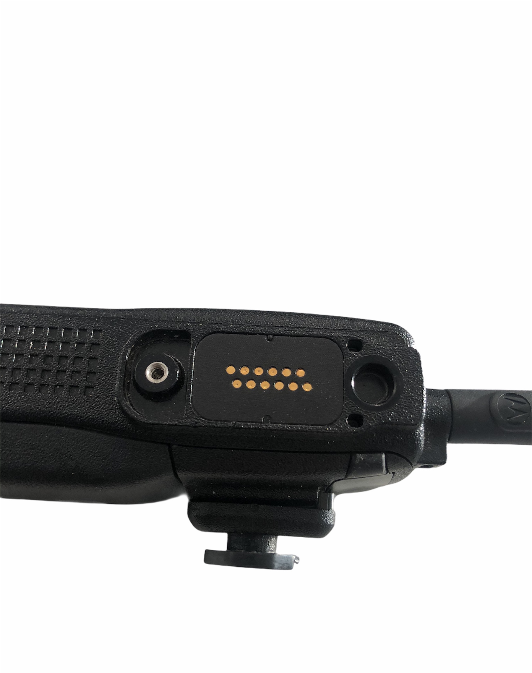

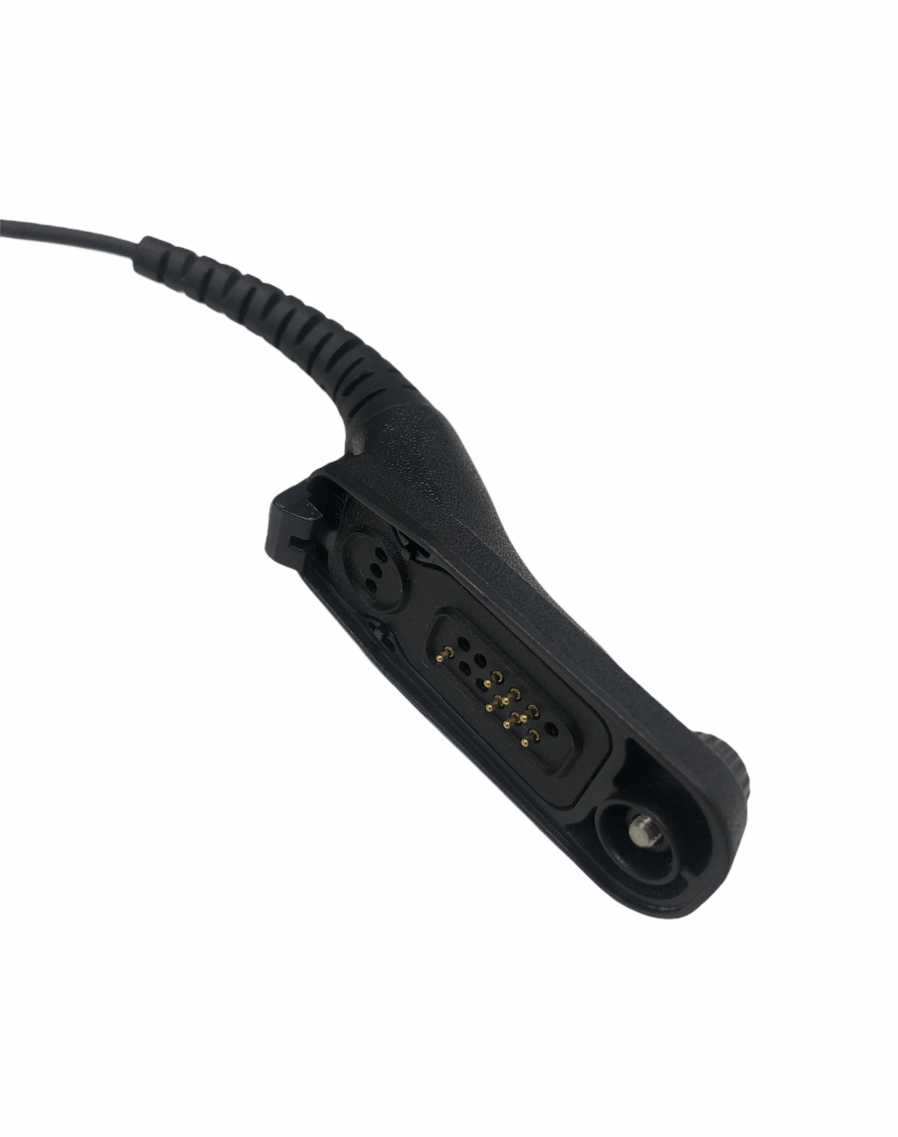

Identify which Motorola M standard port is used, look up the wiring and breakout and note - where there is a +V discrete output or a phantom DC (as there will be on the mic input line), none of them will be higher than a few mA of available current at best.
So, unless you need a few (single digit level) mA worth of 5V DC, you’d be better of finding a higher current source - such as a voltage dropped parallel feed from the radio’s battery pack feed.
