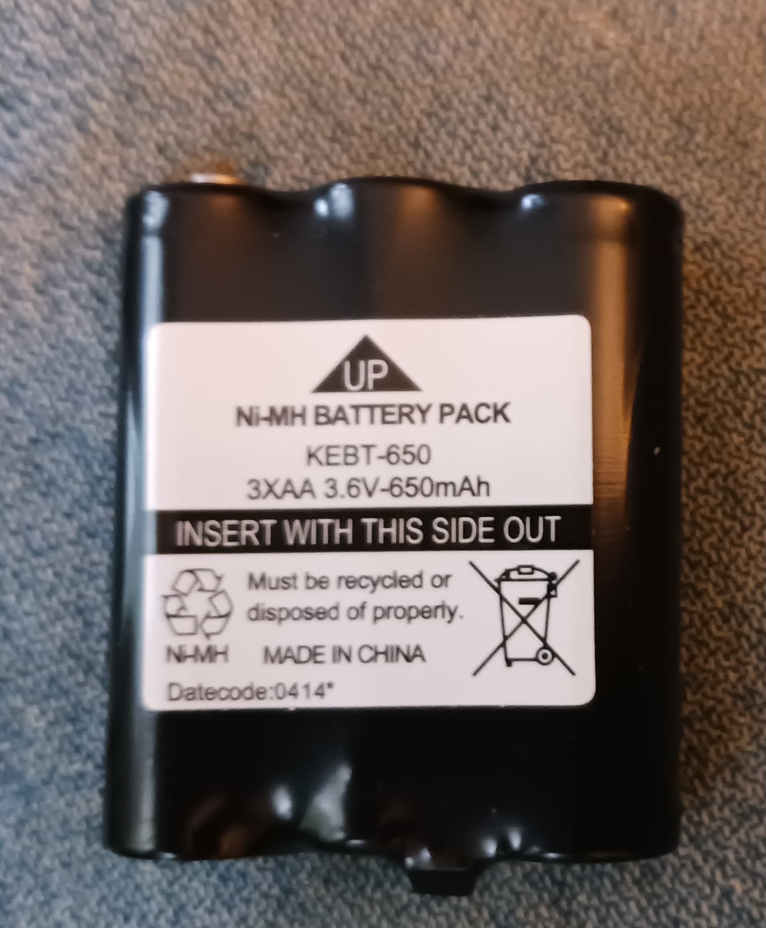

Typos can make a huge difference in the answer, especially when it comes to amps and voltages. You said 1650mAh, but I think you probably meant to type 650mAh. Is that correct?

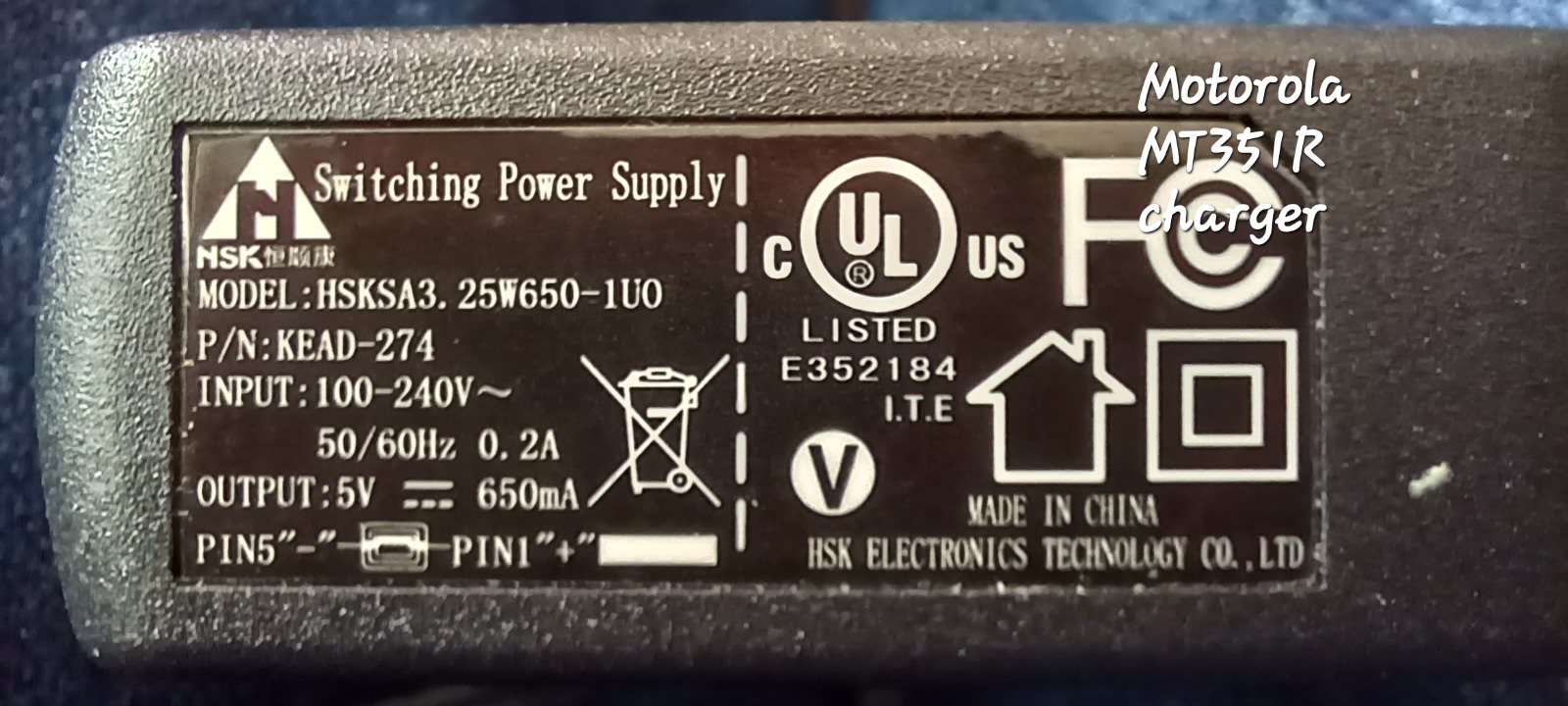

The output listed on the label of the charger (and yes, it is a charger, we’ll get to that in a moment) is 5V 650mA. To clarify, it isn’t about the battery, it’s about what is actually coming out of the charger and into the battery. The battery is capable of producing 3.6v after it is fully charged. The charger is capable of sending 5V to charge the battery. Those are two different things. In this case, the mA is how much amperage is going to the battery. The battery mAh is how much amperage the battery discharges in one hour. Those are also two different things.
Okay, now for the charger itself. The MT350 series radios originally included an AC wall charger with a USB Y adapter that plugged directly into the radios to charge them simultaneously. These chargers were packaged with the MT350R, MT351R and MT352R radios, as well as several other Motorola Talkabout radios of that period.
The radios were sold in 2-packs (aka bubble packs) that also included a pair of 650mAh Ni-MH (aka Nickel Metal Hydride) battery packs, an example of which is shown in the photo you posted above. So far so good.
The distinction between Ni-MH and Ni-CAD (Nickel Cadmium) is important, as Paul mentioned, because the wrong type of battery in the wrong charger can be a real problem. This is why, when you mention the battery type, we need to be sure it is correct. We’re not being condescending or anything, we need to be sure we have the correct information, because it’s potentially a performance and safety issue that can affect the answers to your questions.
These Talkabout series radios were capable of operating on the provided Ni-MH rechargeable battery packs or 3 AA alkaline batteries. The average battery uptime was 10 hours with the Ni-MH batteries and 15 hrs. with the alkalines.
