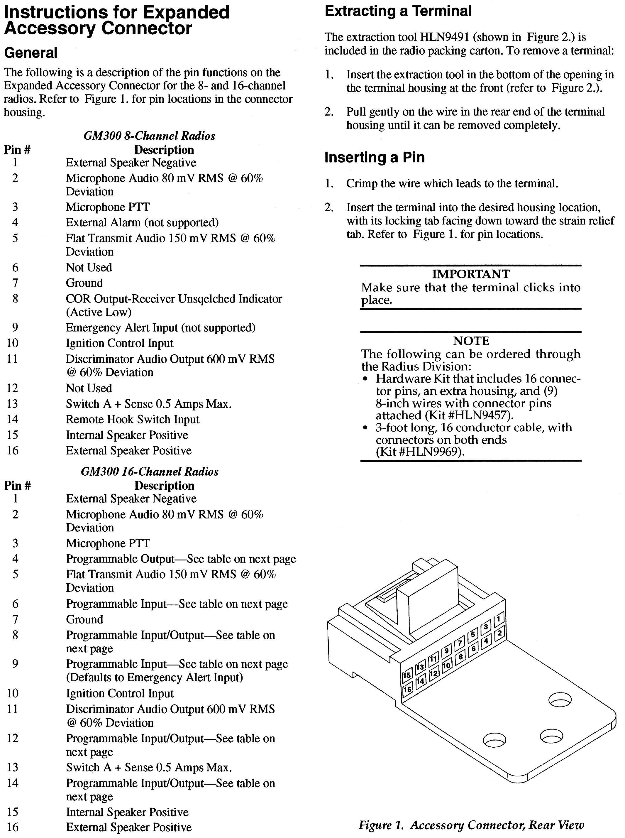

Have a gm300 with 5 pins on the back How do I get the internal speaker to work
Thanks
Allan
Hi thanks for the info /I know the pins on the 16 pin but not the 5 pin thats where im stuck do you have any info abt the 5 pin radio
THX
Allan
you can always use a VOM or any external speaker and pin it out yourself. That is how I would try to do it if information is not available.
