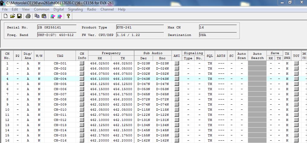

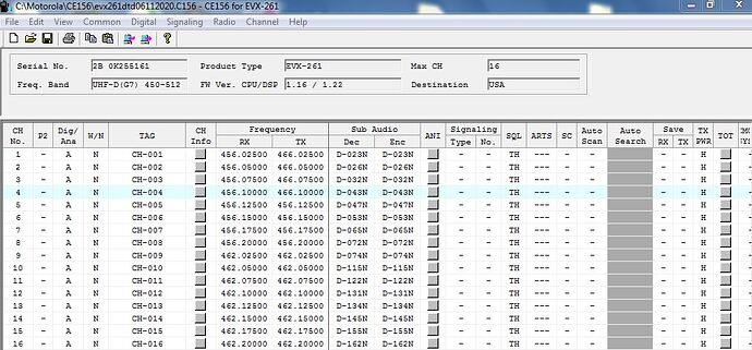

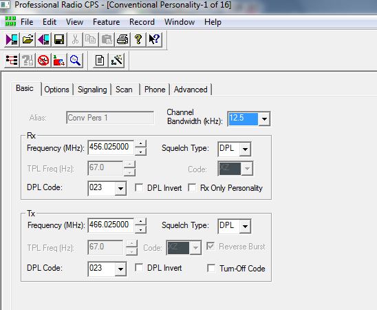

I’ve tried moving both radios to DPL and how when I mic the HT750 I do get a receieve indication light on my EVX-261 and hear static but nothing usable… when I mic my evx-261 I am coming in loud and clear on the HT750. I’ll through up the settings info I have from the programming software.

Why the offset on Channel 1 to 4? Are those repeater channels? You have receive on 456 and transmit on 466. Is that correct? If so, are both radios set with an offset?
Hi CH,
Yes… those are repeater channels… i’ve been focusing my attention on channel 5 with both radios.

I didn’t post the picture but on the CPS software under the signaling tab both RX and TX are set to none.

Stupid question, but they are set to duplex, so you are using a repeater I assume?
Hi Paul,
On the first 4 channels I am using a repeater but i’ve been doing my testing using channel 5 to uncomplicate matters…

Hey guys I dropped back by to close this topic out… I had my head buried in the sand, the radio in question was a dud… when I tried one of the other radios (including all the other radios) they programmed just fine.
So to summarize I configured DPL for both TX and RX with the correct DPL code on each channel and they started working just fine.
