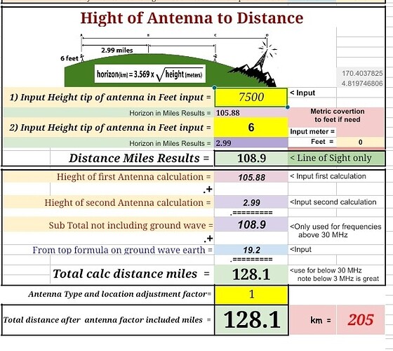

Here a GMRS radio looks great range just top of mountainand get good range. Almost any band that will work . But selling a high cost Radio put guy mountain top. If do math most Radio will get 100 miles. See calcs below on 7,500 feet high.
It is some I see all time on try sell different radios.
Remember most bands can get same range on the mountain :mountain:top
Formulas from ARRL Book :orange_book:

In one post you over simplify and now you over complicate. This topic was talking originally about UHF, then you start talking about CB? So many of your posts have very difficult to understand English. I lost the point of what you are trying to say. Radio manufacturers have always over estimated range, and used qualifiers. Range is up to 50 miles with repeaters. Not really a lie? Effective real world range 200m would not be a great claim would it? You invented a silly rule to ‘help’ people with range, and now you post a new ‘helping’ post greatly mangling your earlier one. I don’t understand what on earth you are actually trying to do?
