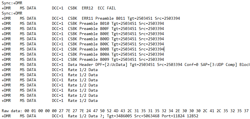

When i send from Bao, i get such log

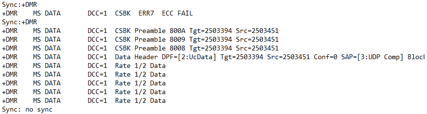

When send from Kydera

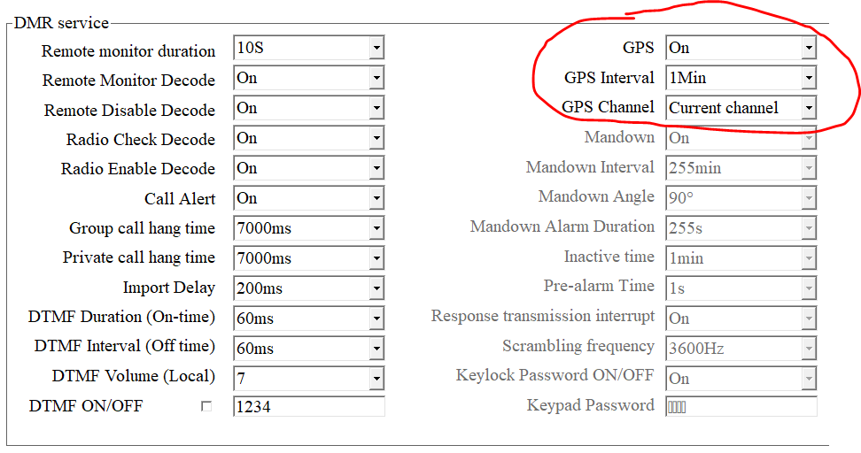

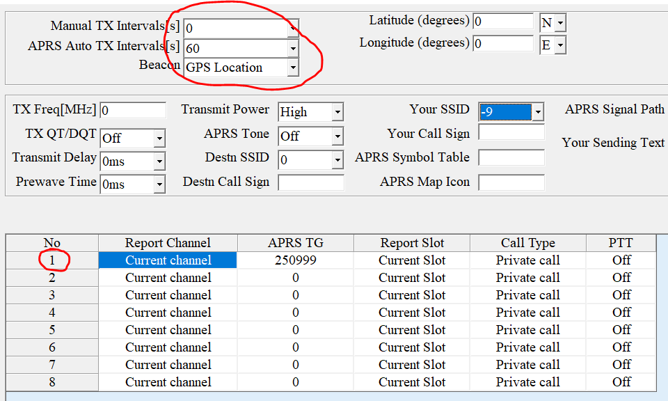

I made such settings
