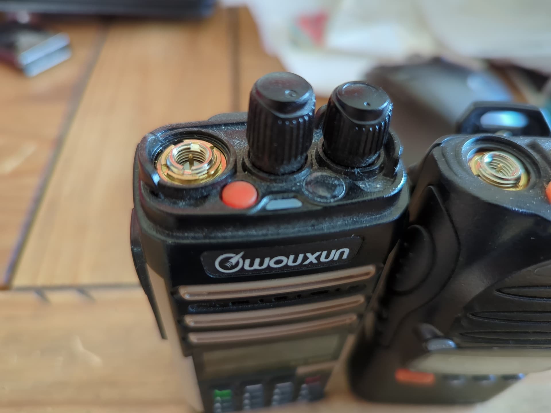

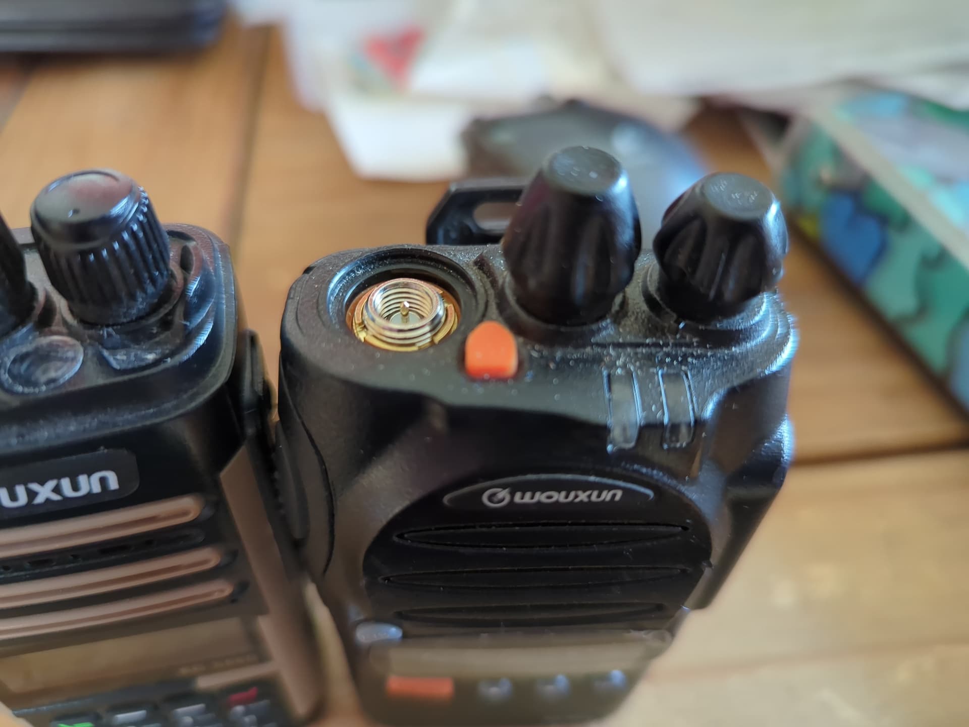

I was looking at the antenna connections on the S88 and one of the 805’s. I noticed that the brass ring on the outside of the SMA “barrel”? looks like it has been tightened down more on the 805 than on the S88. Hopefully that makes sense. I will try to upload a couple of photos to show everyone. I might not mean a thing, but if it were the problem, this would be a simple fix.
That’s quite common and depends on the panel thickness - with SMA type connectors, the important thing electrically is the inner thread and pin BUT remember most of the mechanical strength comes from the fit of the outside of the antenna. This means that on the Wouxun the SMA could bottom out in the socket, but the outside may not be touching the case plastic on some antennas, which means the strain is on the very weak SMA - on the other it looks fairly normal.
After comparing it to other S88G models, the rings appear normal, so I don’t think any tightening is necessary at this point. The 805G generally performs slightly better than the S88G, averaging about 2-1.5 dB stronger reception. However, it seems that in this case, your 805G is performing substantially better than your S88G. This suggests that either the S88G may be underperforming or the 805G is exceeding typical performance.
