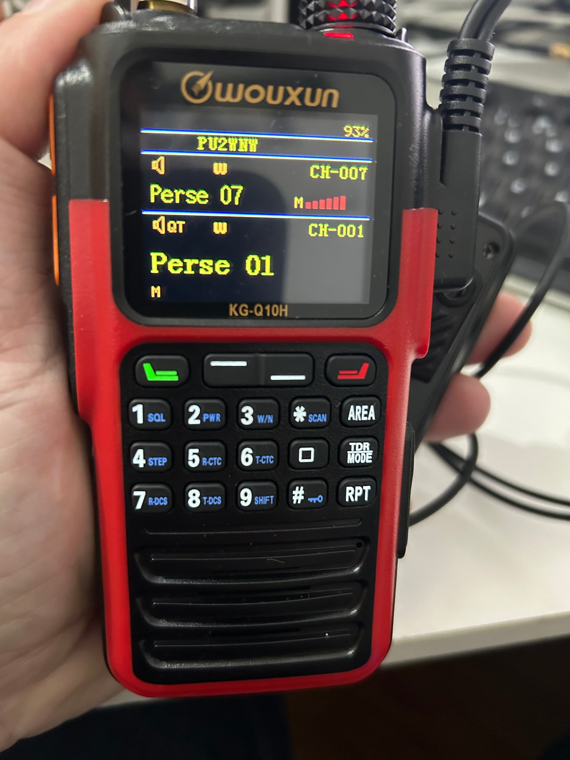

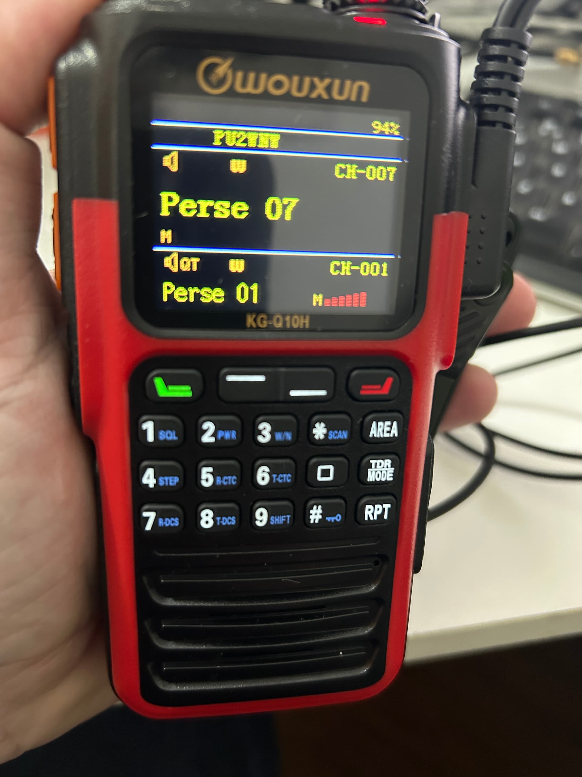

When I connect a headset to the radio in dual-channel mode, pressing the PTT transmits on the wrong channel. Instead of transmitting on the selected channel, it transmits on the other channel.
Is this normal, a defect in the radio, or did I make a configuration error? Note that neither of the channels is marked as a favorite.

I solved the problem!
I’ll post it here to help anyone who might make the same mistake as I did. :smile:
In CPS, under the “Key Settings” tab, I changed the “PTT1” assignment to “SECONDARY” and left “PTT2” as “MAIN.” This made the headset PTT always activate the secondary channel that was programmed in “PTT1.”
